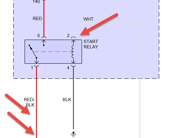

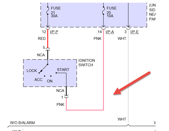

Whatever it is it's sending power to the starter when the ignition is in the run position when it shouldn't be. Is there a diagram on how to check the switch with a meter..Thanks!!

see pics if lwht wire is sending power to relay and pink is not sending to trans switch then the trans switch may be the culprit. dual arrows on one pic go from relay to starter. one arrow on same pic comes from trans switch.

With key on I assume?
Jul 30, 2017 at 1:05 PM
HMAC300
  • 48,601 POSTS
yes or in start position for one wire
