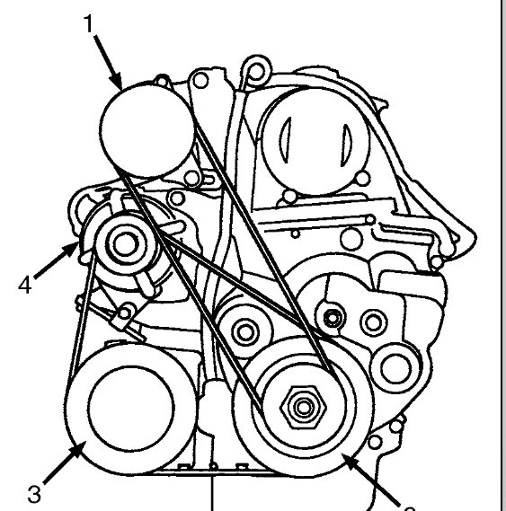

first if you can hear it sitting still take the belt off and start motor see if it goes away you didn't put mileage down but belt and tensioner should be replaced at 60, 000 mile intervals if belt is frayed then it should be thrown away. tensioners lose tension. also check alignment of belt to check if everything is aligned. ifno tensioner belts should be adjusted with a belt tension gauge and pulleys check for bad bearings.
