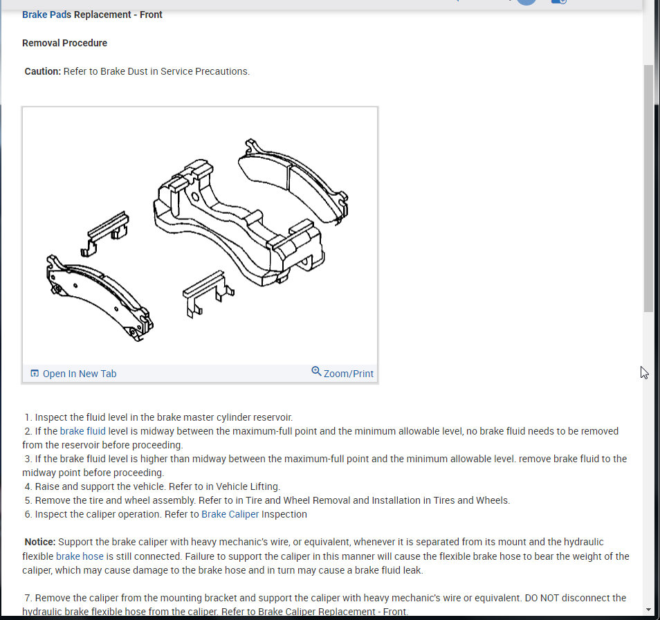

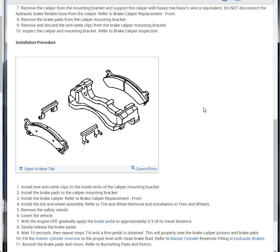

I also attached below the process from the manual on how to replace the pads. if this is the issue then you will need to replace the rotors as well.
