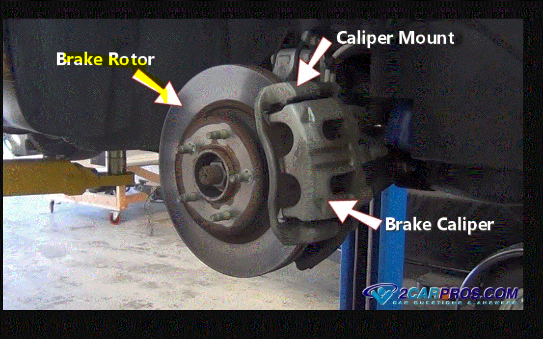

Do me a favor. Look through the front wheels at the brake rotors. Is there any evidence of something cutting into the steel brake rotors?
Take a look at the picture below. It shows a brake rotor. I suspect they were replaced with the brakes. Just check to make sure there is nothing cutting into them.
Also, if the rotors appear good and undamaged, in a safe place, gently apply the parking brake while moving to see if the noise is evident. At least that way we can determine if it is from the front or the rear.

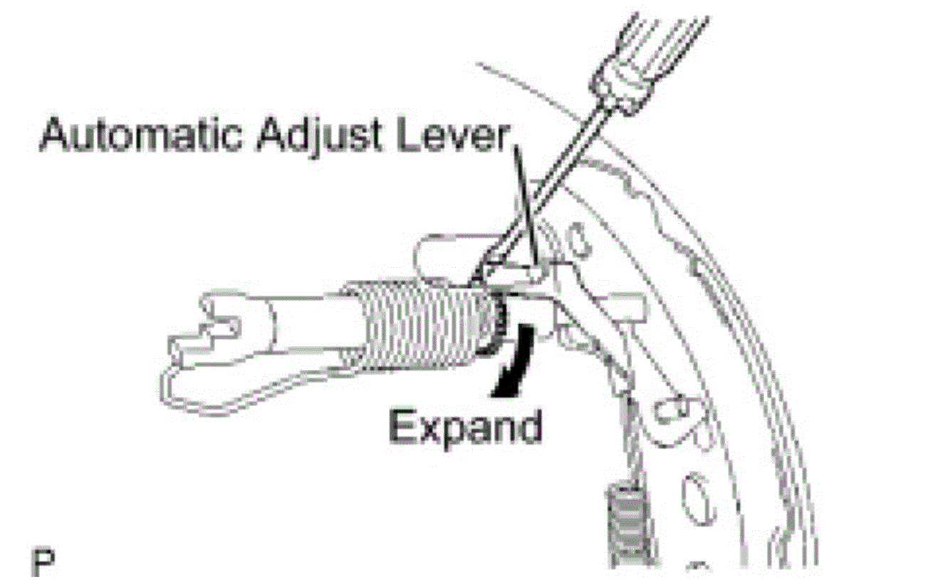

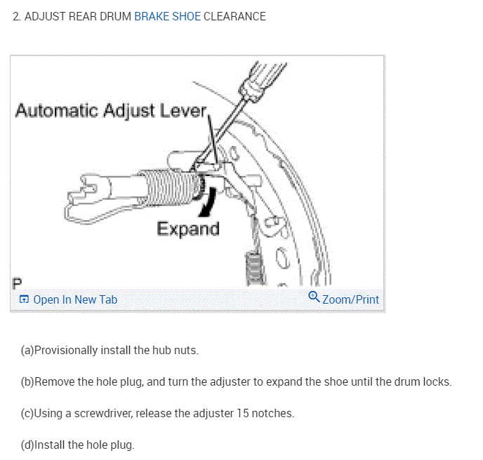

See pic below.
