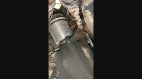

So I was looking under my car today and noticed a green slime-ish looking substance running down the frame of the car, it is close to the CV axle on the passenger side. I do not know if this is coolant leaking, but I have not had any leaks or wet spots under the car when I leave it parked. I do not know where the leak is coming from, I tried to get a good shot from above the leak but did not do the best job. Any guesses?

If there is any way you could video looking up toward the leak, it will be helpful for me. I do see the coolant you are referring to, so there is a leak.

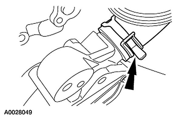

3. Remove the splash shield.

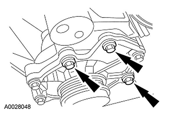

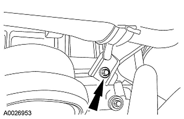

Picture 1
4. Disconnect the heater water hose from the bottom of the water pump.

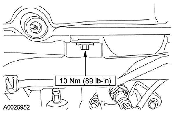

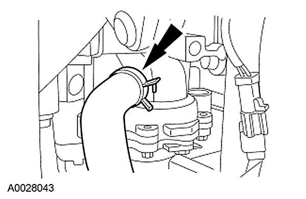

Picture 2
5. Remove the radiator lower tube bolt.

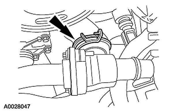

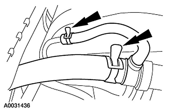

Picture 3
10. Remove the radiator upper front tube bolt.

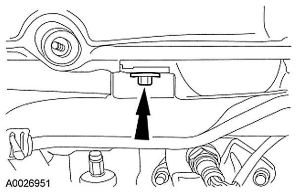

Picture 4
11. Disconnect the upper radiator hose and engine vent hose.

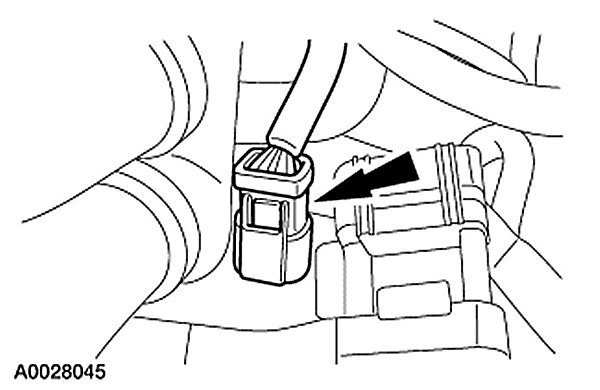

Picture 5
12. Disconnect the transmission 10-pin connector.

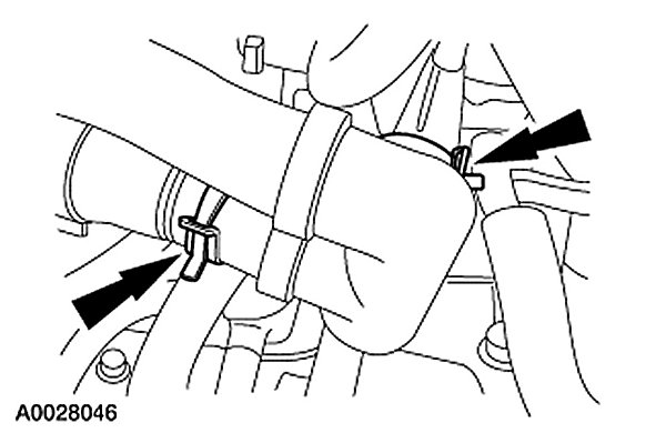

Picture 6
13. Remove the radiator bypass hose assembly.

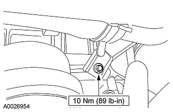

2. Position the water pump and install the mounting bolts.
- Tighten the bolts in two stages.
- Stage 1: Tighten to 10 Nm (89 inch lbs.).
- Stage 2: Tighten an additional 90°.
Picture 11

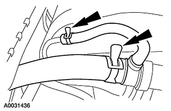

Picture 14
6. Connect the upper radiator hose and engine vent hose.
