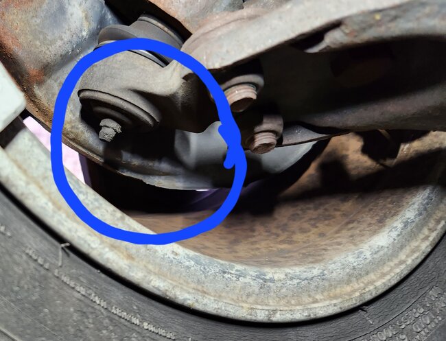

I am having a squeaking noise coming from the tire area. I am trying to grease the fittings. Does someone have the location of the grease fittings?

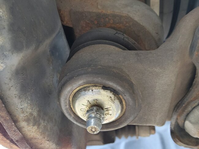

After listening and looking, I found a "Grease Fitting" on the car's front passenger side steering rod. I was not told that my mother in-laws' car had the steering rod replaced. A friend had a grease gun and filled it. The squeaking noise went away.
Mar 30, 2023 at 9:57 PM
Thanks for getting back to me, I didn't think these cars had grease fittings. Sorry about that. I am glad you got the problem fixed.
