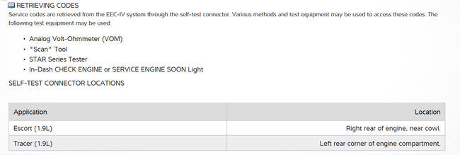

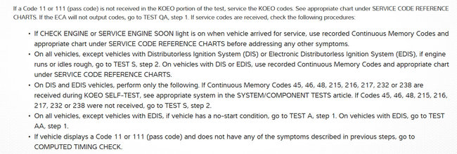

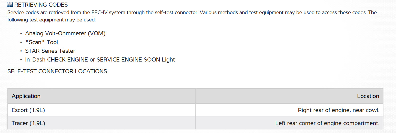

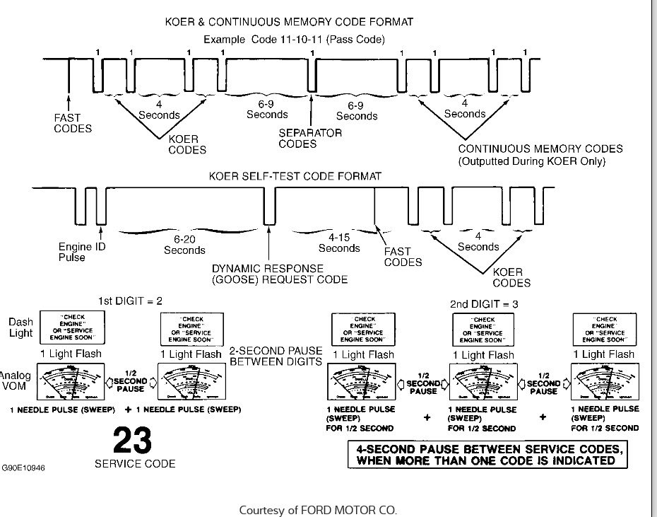

scan for codes first. See pictures.

I am not able to, the car will not let me.

if you cannot scan for codes then you will need the special tool to diagnose why no spark. otherwise buy all he ignition parts new and replace them or park it if you cannot afford to fix it.
