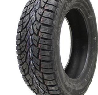

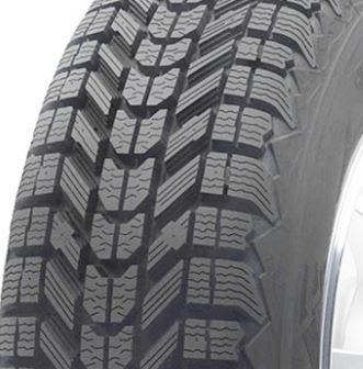

Goodyear makes good tires, the issue is the tread pattern and compound. A tire that is going to be good in snow will have a compound that doesn't get stiff and a tread pattern that self cleans and is broken of with a lot of horizontal siping. The Wrangler ST is not a snow tire, it is an all season touring design. The tread pattern is more like an older summer tread. Will they work in snow? Maybe but not very well. Laufenn is made by Hankook. The tread pattern on the ones you selected is not a snow type tread either. Again they may work in snow but not as well.
Out of the three you list the Eldorado has the closest thing to a snow tread pattern and it's not that great.
The first image is a Firestone Winterforce2 snow, they run about $100.00 a tire at Wal~Mart. They are a true snow tire however. The catch to that is you do not want to run them all year as the soft compound doesn't like heat and will wear out very fast.
second is a General Altimax from the same store. They are also a true snow for about $105.00
As far as price goes, you are riding in a vehicle at speed on 4 contact patches roughly the size of your hand. They have to move forward, turn and stop as needed. My suggestion would be to get a set of 4 true snows mounted on the rims you have. Then visit a salvage yard and get 4 replacement rims and before summer arrives get something like the tires you have posted above mounted on those. That way you have the better tires for both applications. Or if the current tires are good get the rims and mount the snows on them.
