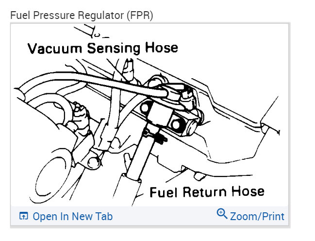

Also, the fuel pressure regulator is dependent on the engine vacuum to function. It is located on the fuel rail. See pic below. Confirm the vacuum hose to the regulator is connected and not damaged. With the engine running, you should feel a constant vacuum at the end of the hose, so confirm that as well.
Let me know what you find.
See pic below.
