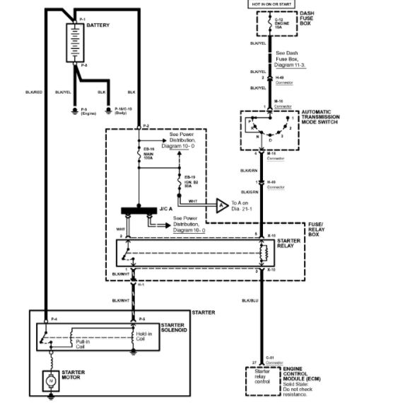

I checked the relay its good but when i check the ports the relay goes in should have two sides that light up shouldnt i?i put in on pos side of battery for ground got only one hole to light up put on neg post got two holes to light up i think one of the relay holes is down to far or shortedout.
Mar 25, 2018 at 5:51 PM
Ok, there should be 2 terminals with voltage. one of the others is grounded by the ecm . that is the control side. when the relay engages, it will power the last wire that goes to the solenoid.
diagram attached
Mar 25, 2018 at 5:57 PM

You tested it wrong. you put the ground on the test light to the negative side and test voltage at the relay.
it still sounds like you have a bad battery.

check all your fuses with the test light as well. power to the relay comes from the fuse block on one terminal as listed in the diagram I sent you. the other power is from the ignition switch in the start position.
