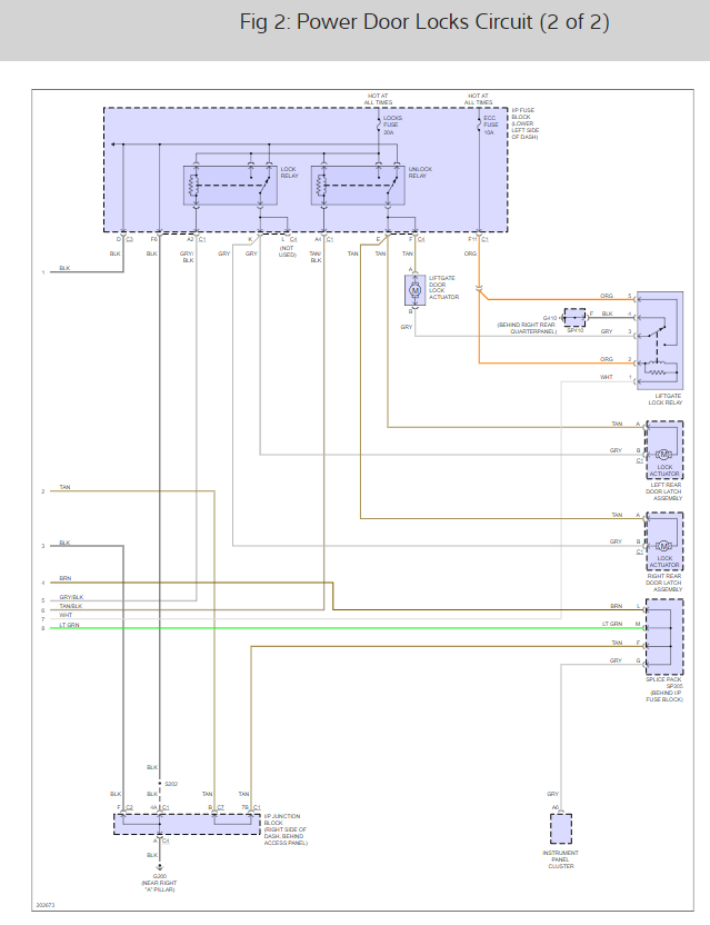

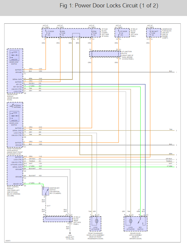

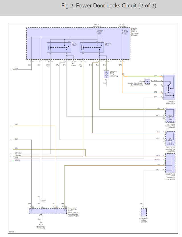

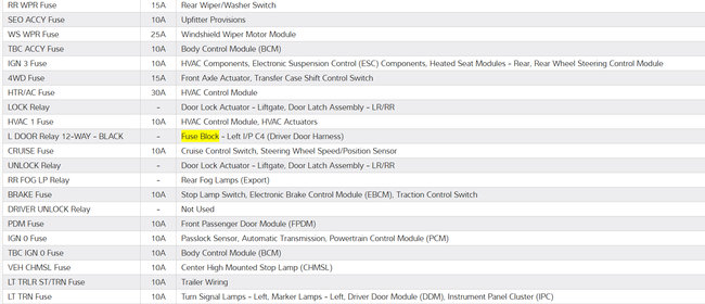

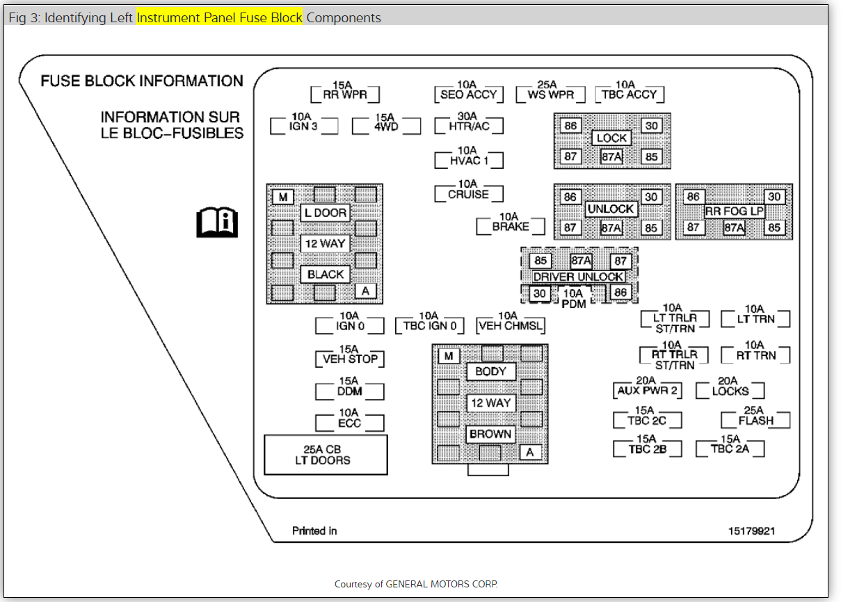

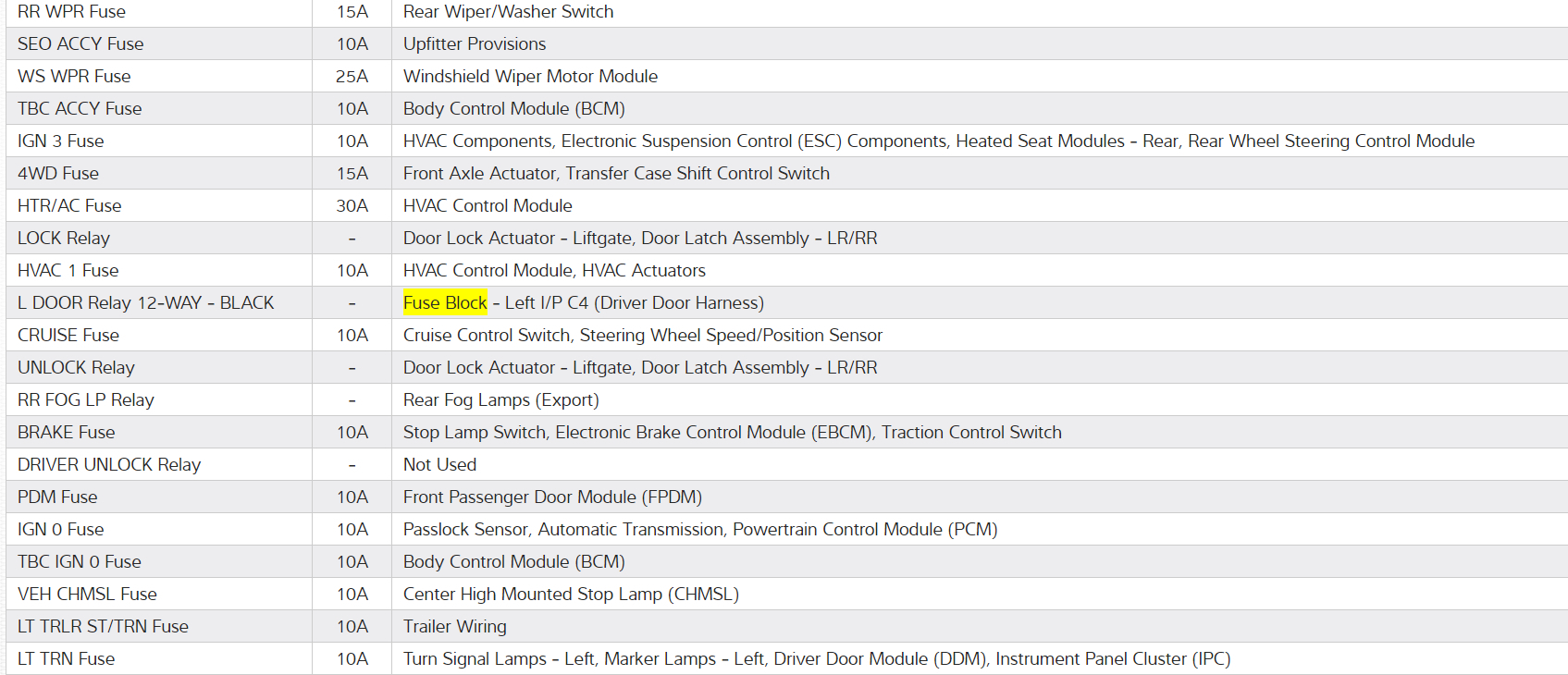

Yes, is sounds like you have a unlock relay that is not working. Here is a guide to help test it:

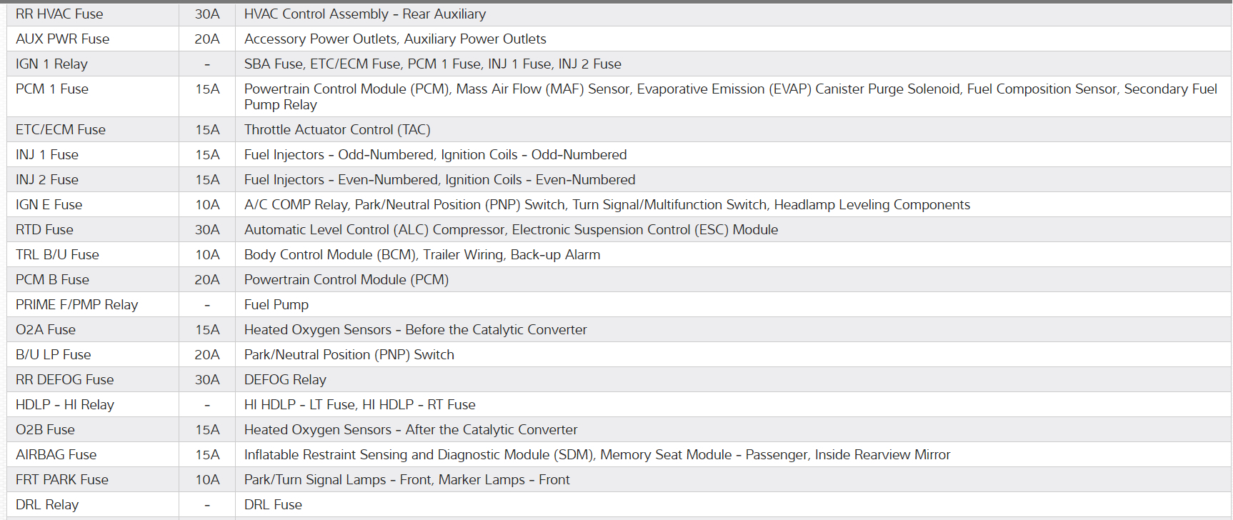

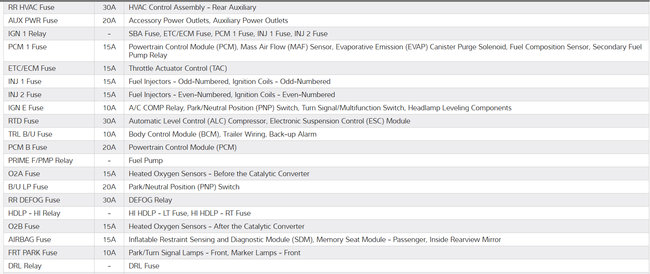

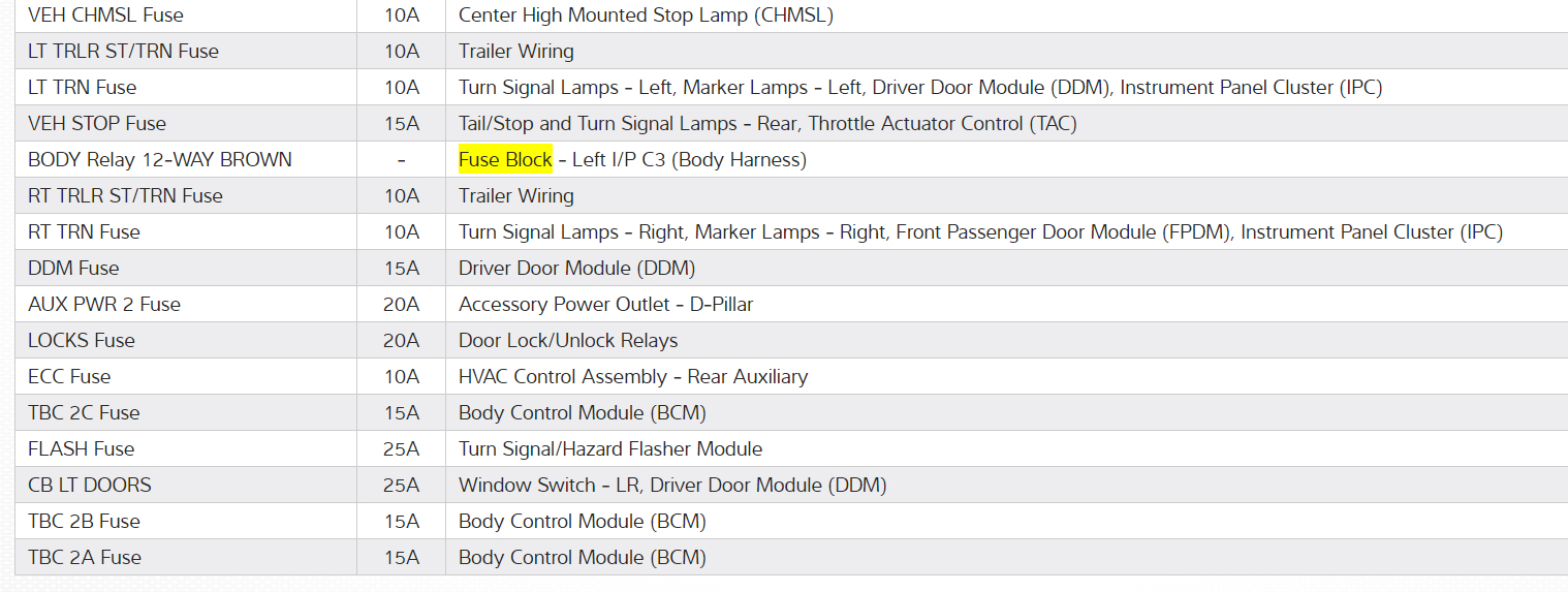

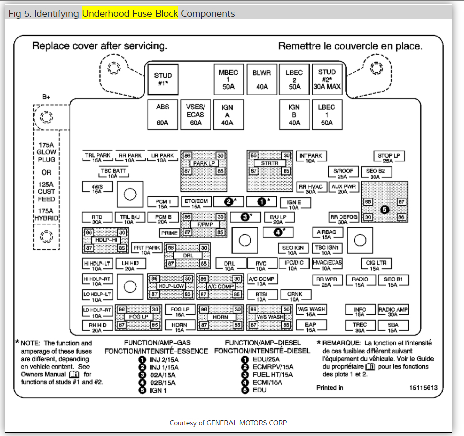

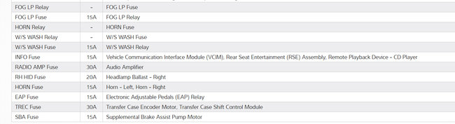

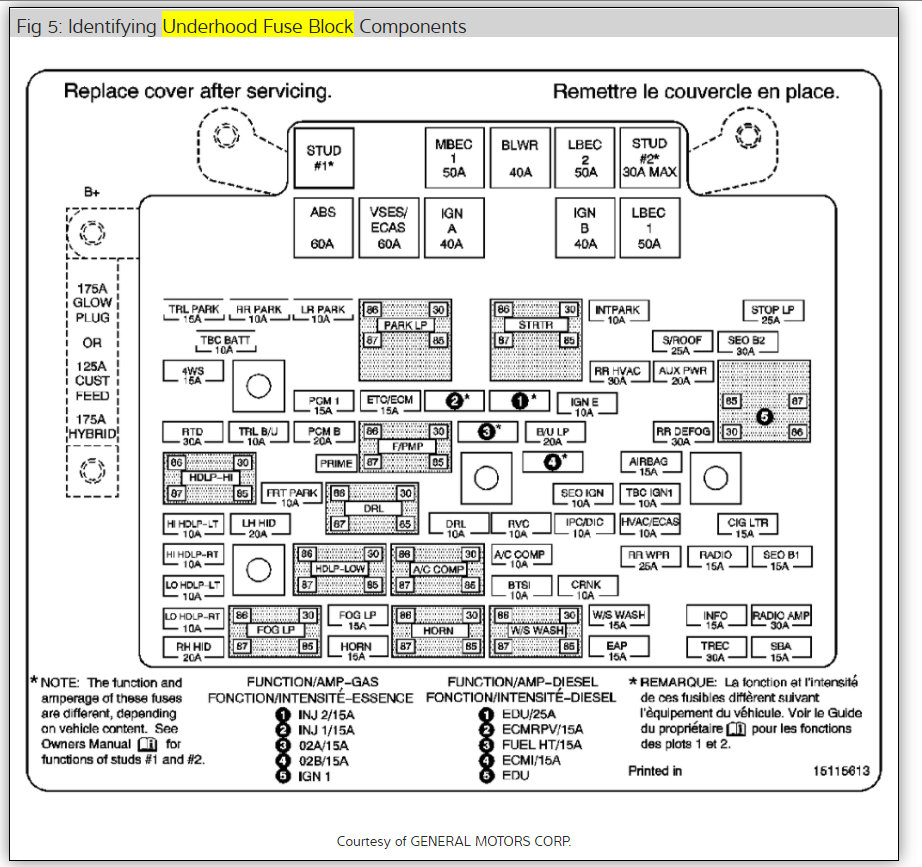

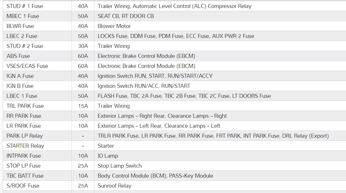

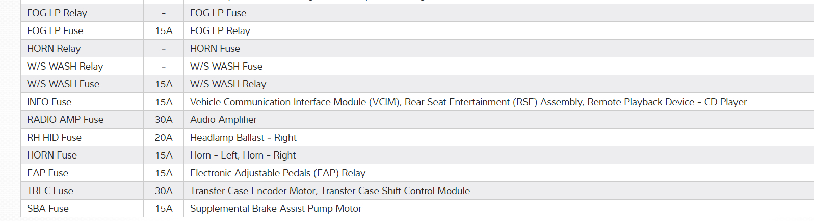

Here are the wiring diagrams and relay location so you can see how the system works and to replace the relay. The relay is in the interior fuse panel.
Check out the diagrams (below).
