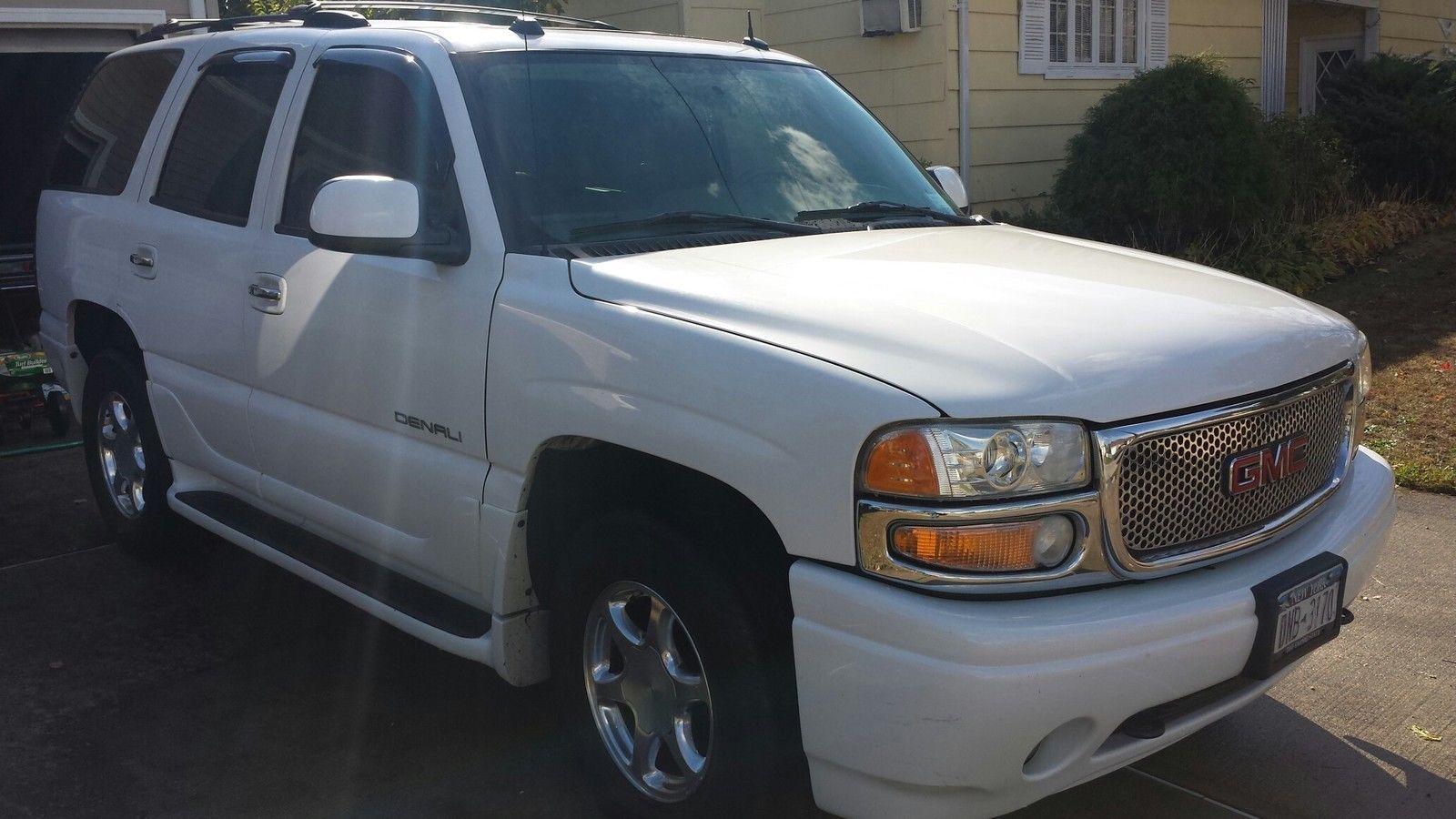

I bought this Denali privately and soon learned that the cruise control did not work. I tried everything I knew (which is not much) to get it to work but it wouldn't come on. Then one day when I was towing a utility trailer, the cruise control worked perfectly. Since then I have not towed anything and the cruise control refuses to work. I tried pulling the brake pedal forward while driving, thinking that it may be the brake switch, but that didn't fix anything. Will you please help me?
