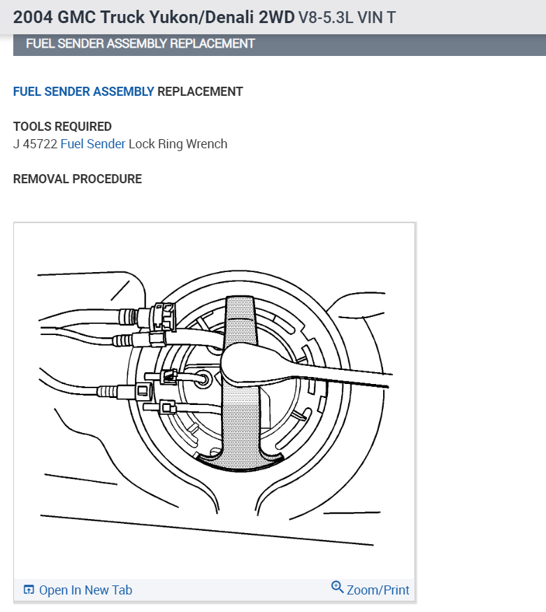

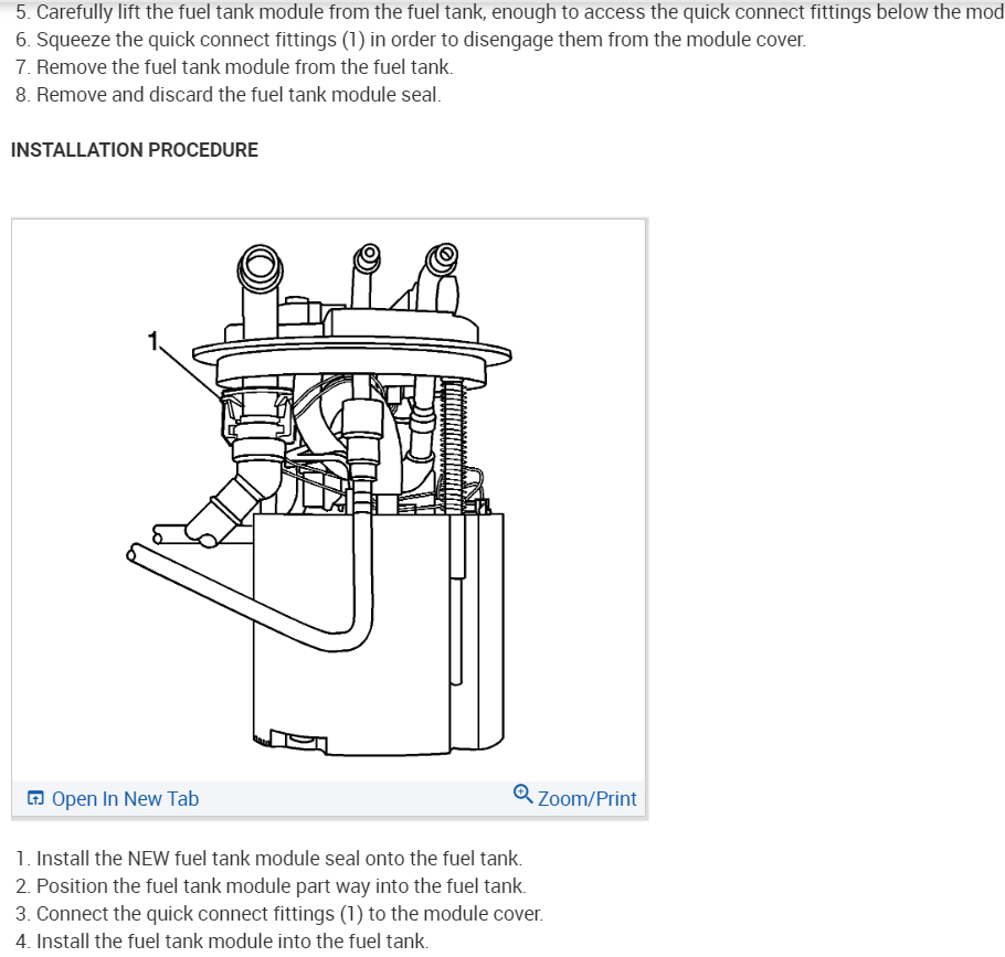

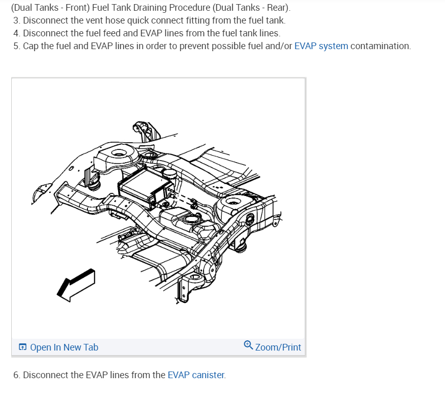

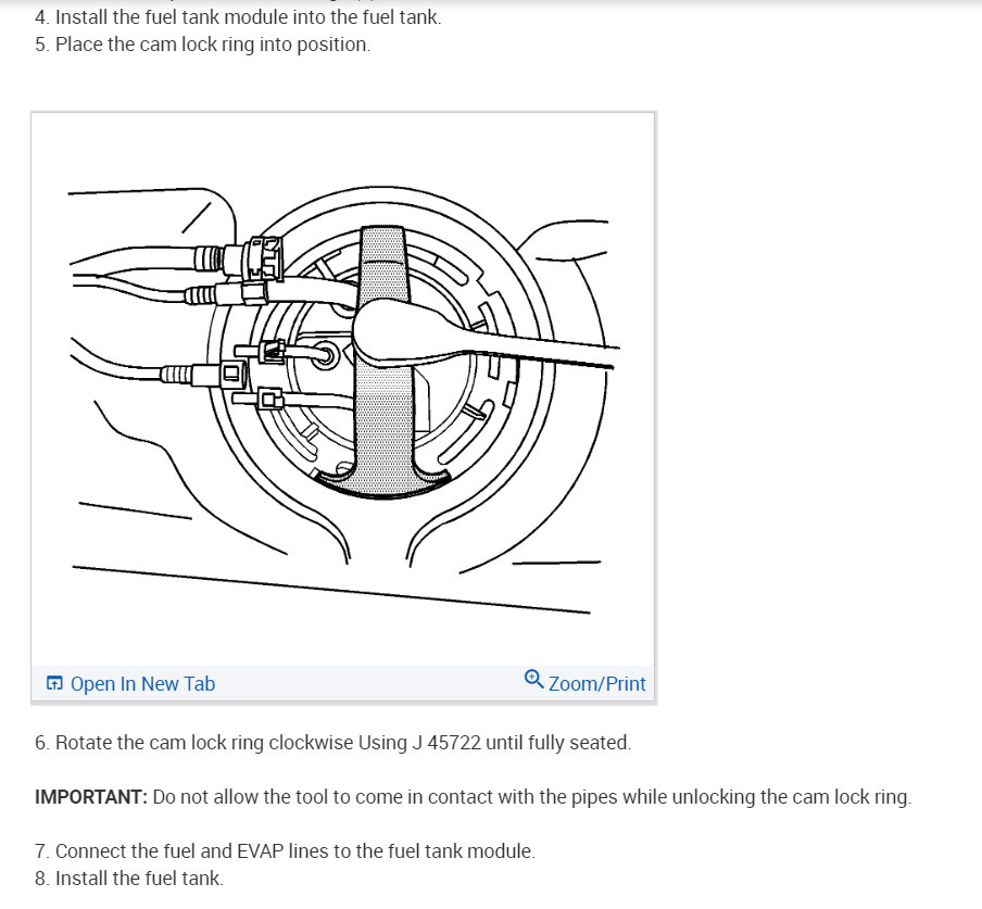

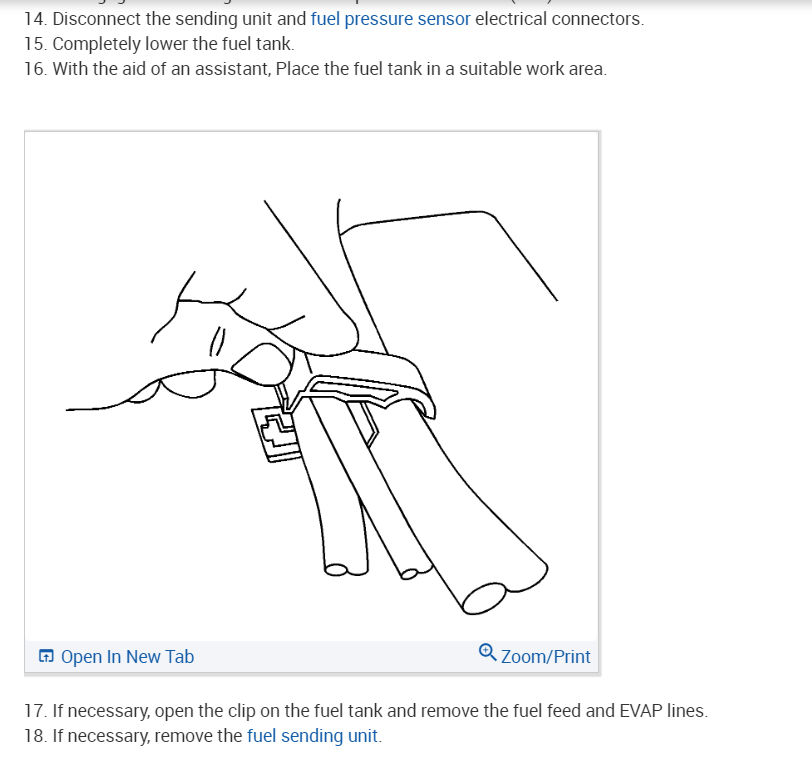

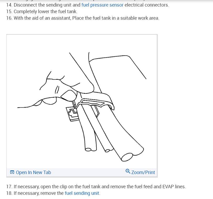

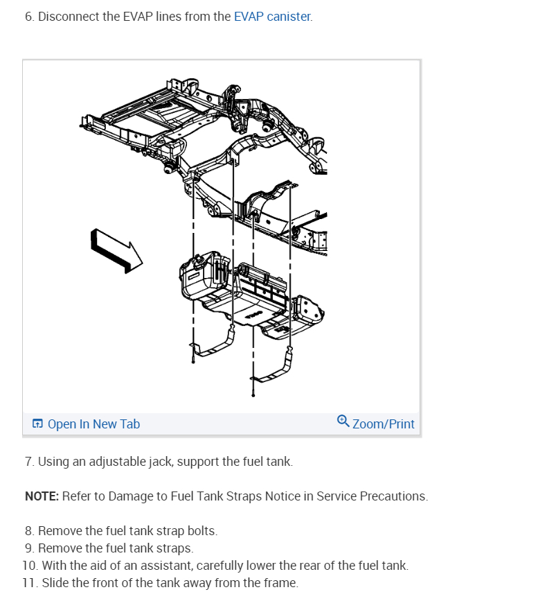

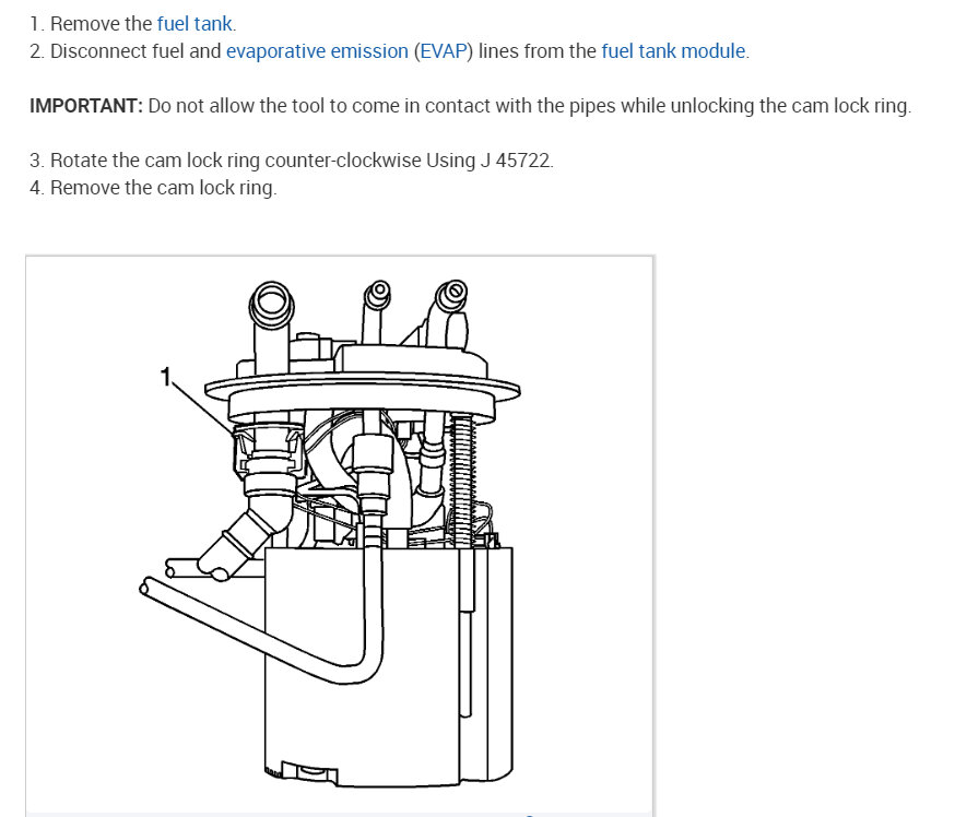

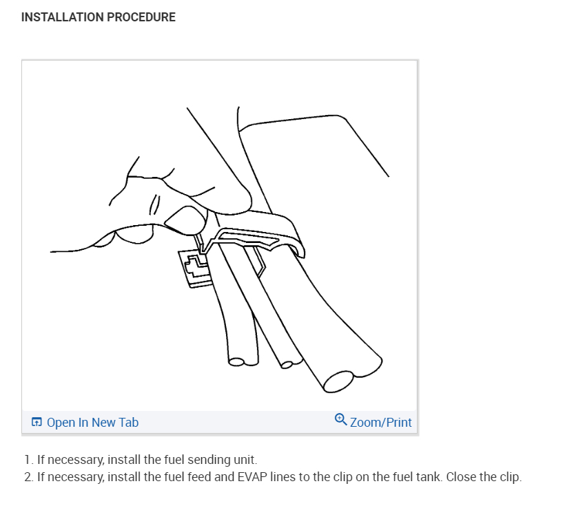

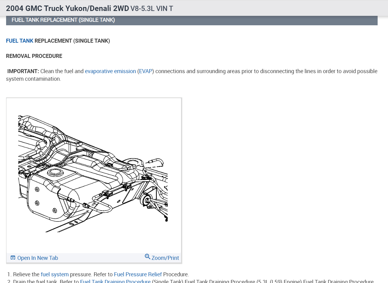

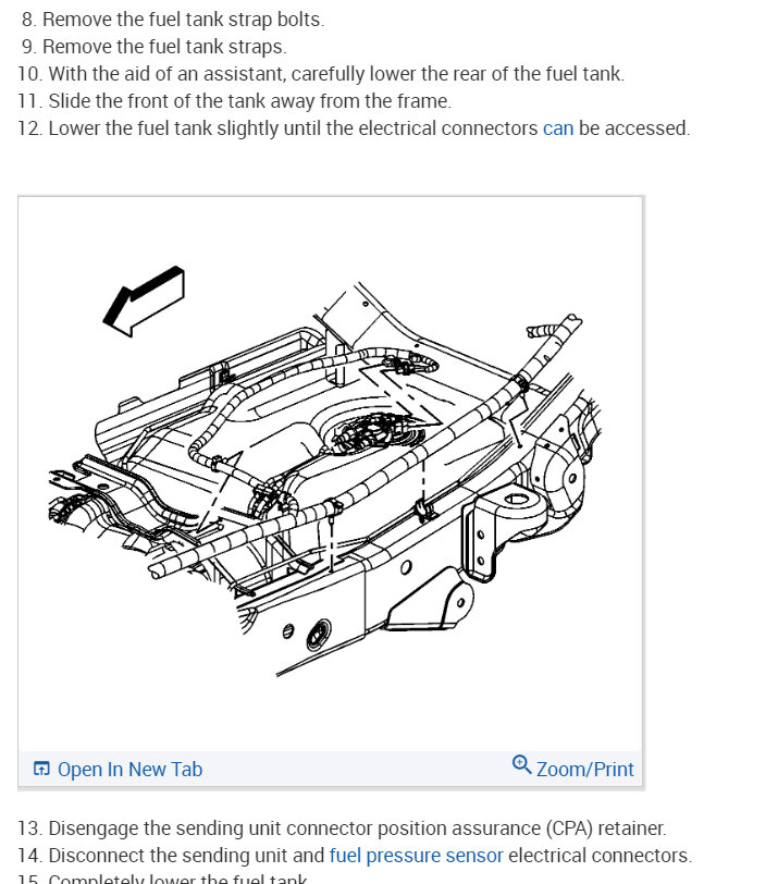

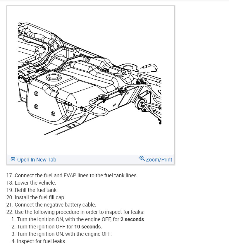

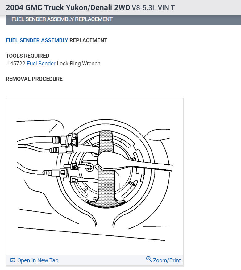

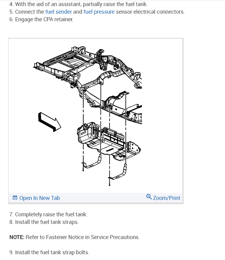

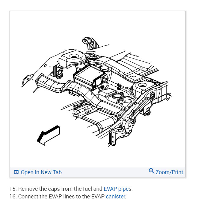

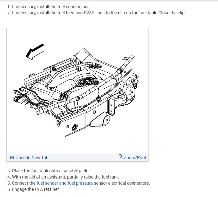

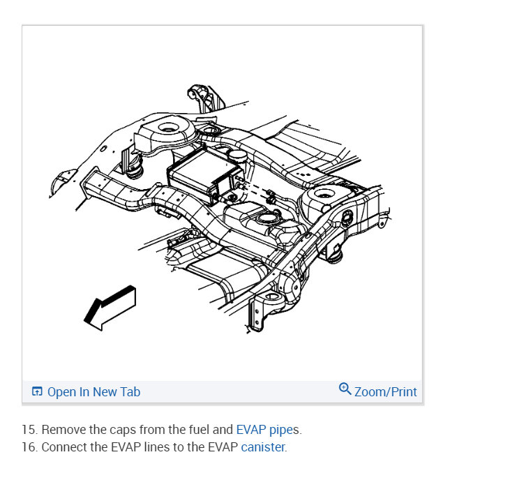

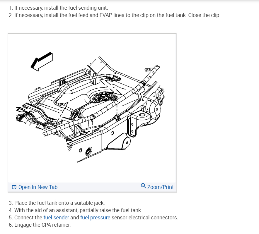

This is common when the fuel pump goes out be to be sure let's do a fuel pressure test by following this guide:
Fuel pressure .................... 385-425 kPa (55-62 psi)
Here is how to change the pump out in case you need it. Check out the images (below). Please let us know what happens.
