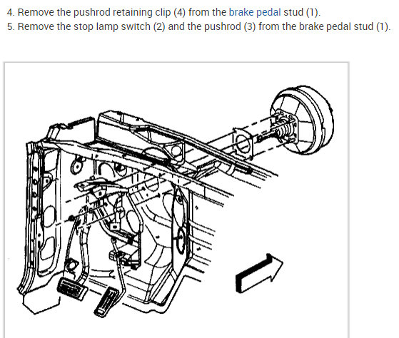

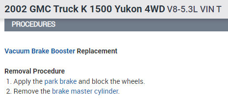

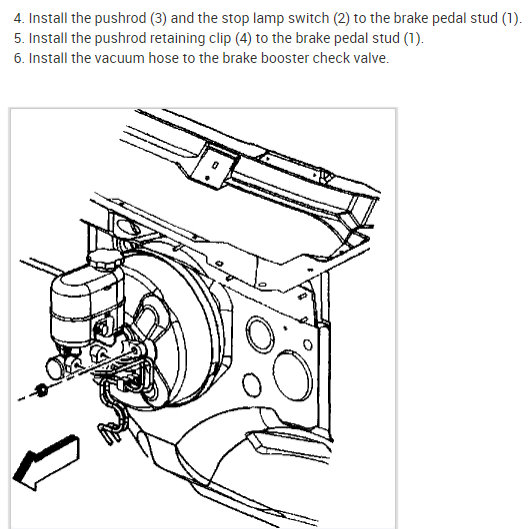

Here is the information you requested. I've attached picture steps below for removal and replacement of the power brake booster on your vehicle. Hope this helps and thanks for using 2CarPros.
