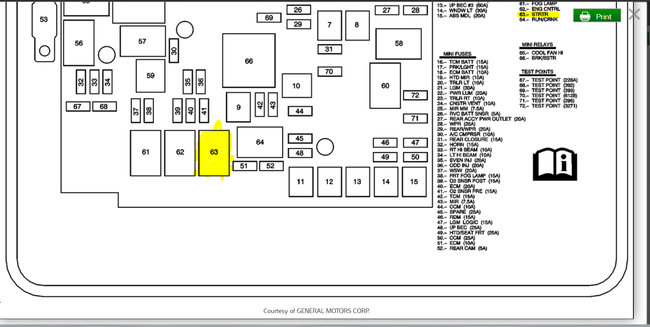

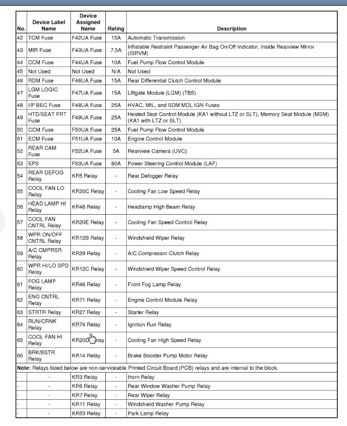

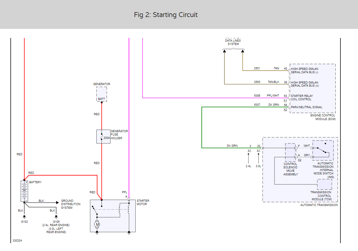

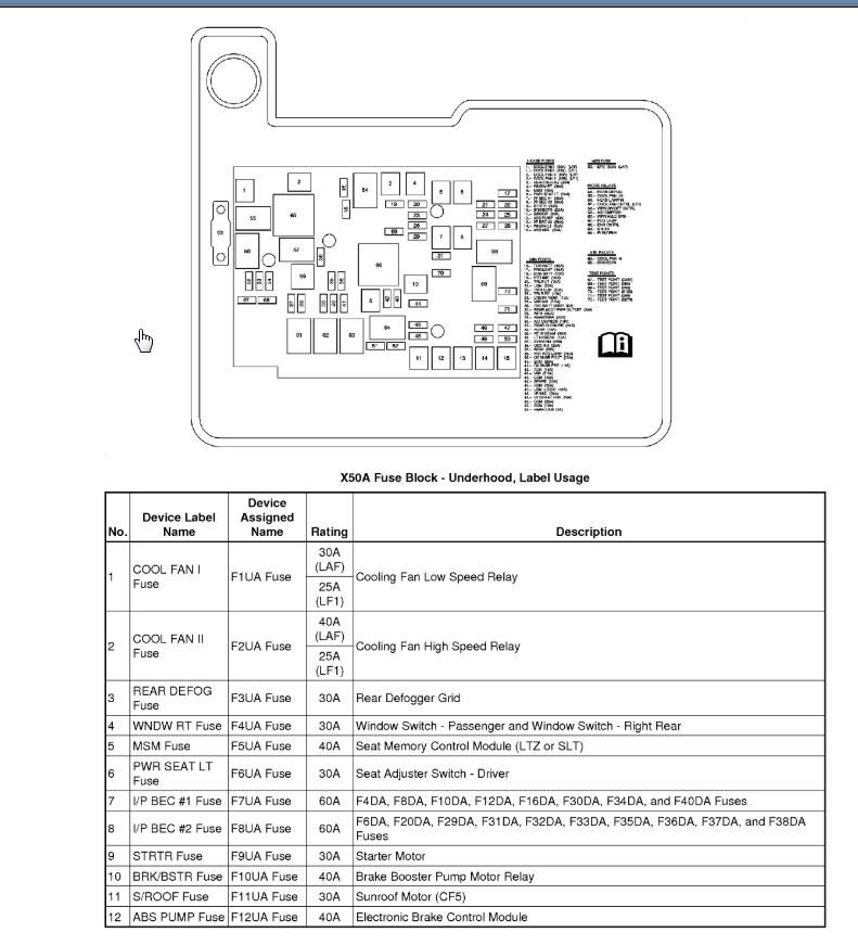

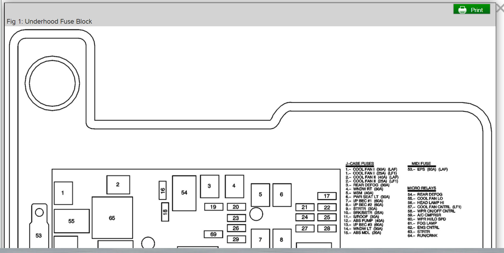

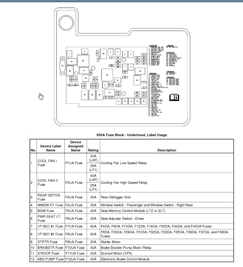

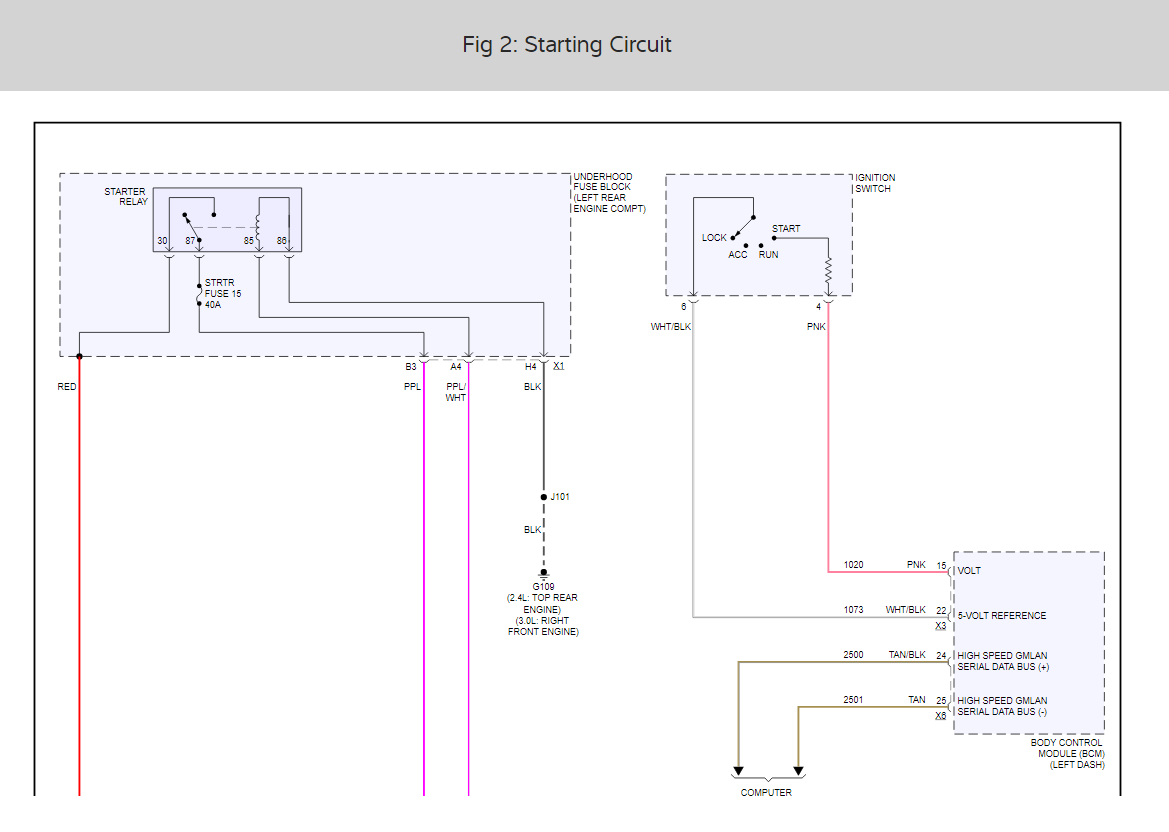

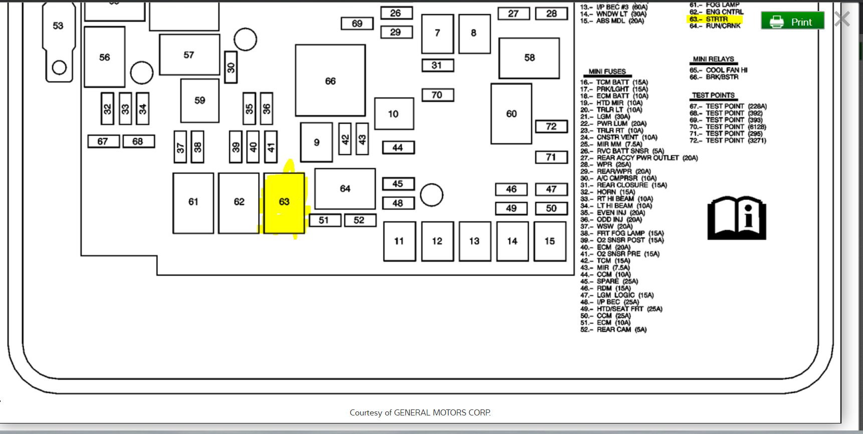

This could be a problem with your vehicle's starter relay. The starter relay is what allows the electricity to go to the starter and start your vehicle.In the diagrams down below I have included a wiring diagram for your vehicle's starting system as well as an under hood fuse block diagram where the starter relay is located. Here is a link for you to go to as well:
Please go through these guides and get back to us with you are able to find out.
