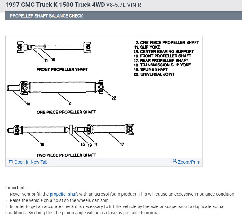

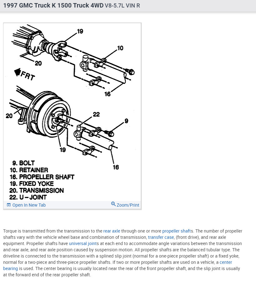

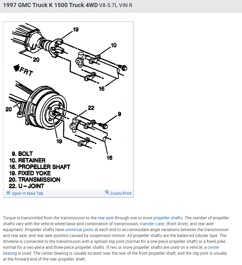

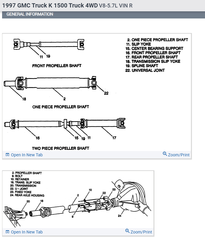

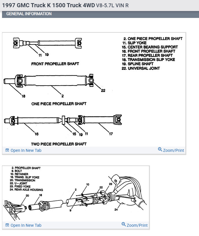

I have attached diagrams for the drive shaft as well as how to check for imbalanced shaft below.
