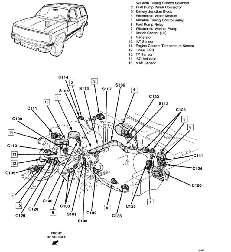

Hey BEAVERWELCH
This sounds like a classic MAP sensor problem. This guide can help as well
https://www.2carpros.com/articles/engine-surges
Check out the diagrams below to show you on your car. Check out the diagrams (Below). Please let us know what happens.
