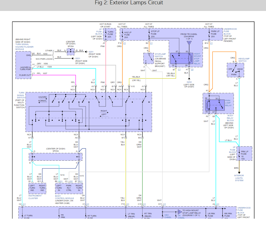

Where's the wiring diagrams?
Feb 3, 2023 at 9:01 AM

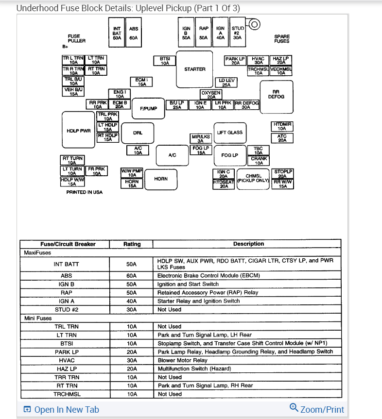

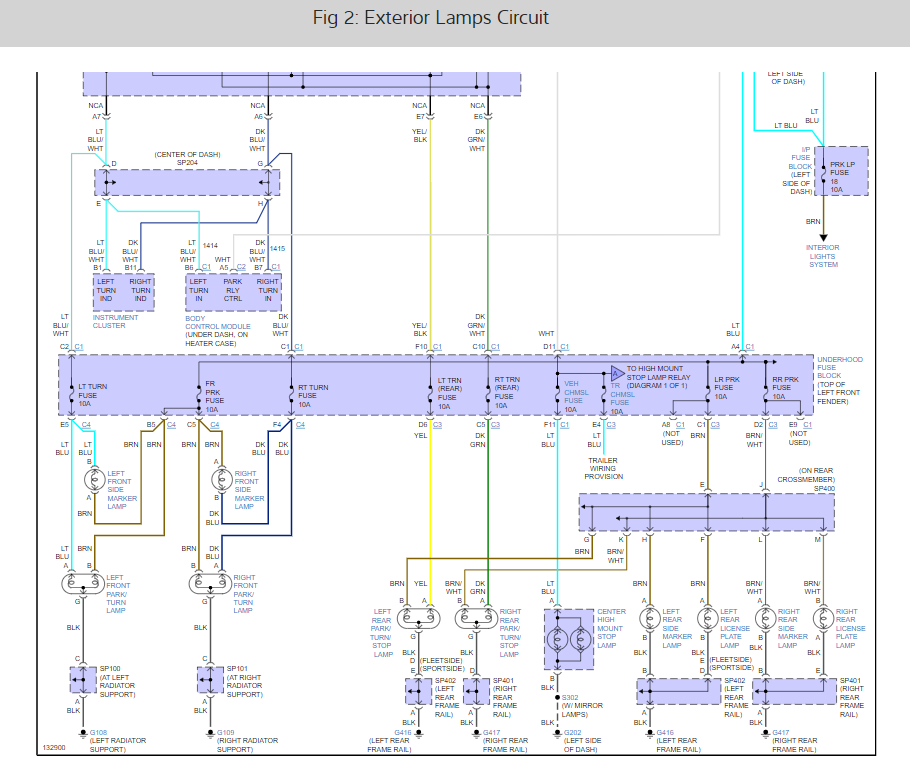

Check the trailer wiring if there is any, these can cause shorting issues also there is a high mount stop light relay and a running light relay that can be causing the issue as well here are the wiring diagrams so you can see how the system works. Also check the front and rear sockets because they can heat up and melt. Check out the images (below). Let us know what happens and please upload pictures or videos of the problem.

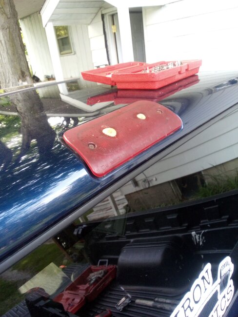

I believe the relay is good because I switched it out with the horn relay and got the same effect. The high mount stop lamp cover melted. The stop lamp fuse was blown, I replaced it and the right and high mount stop lamp work with brake pressure applied. I still have some troubleshooting to do but I got it narrowed down thanks to you guys. Could it be the high mount lamp assembly itself that's shorted?
May 21, 2023 at 2:15 PM
Yes, it could be, but you said it is working? Also do any of the other brake lights work?
