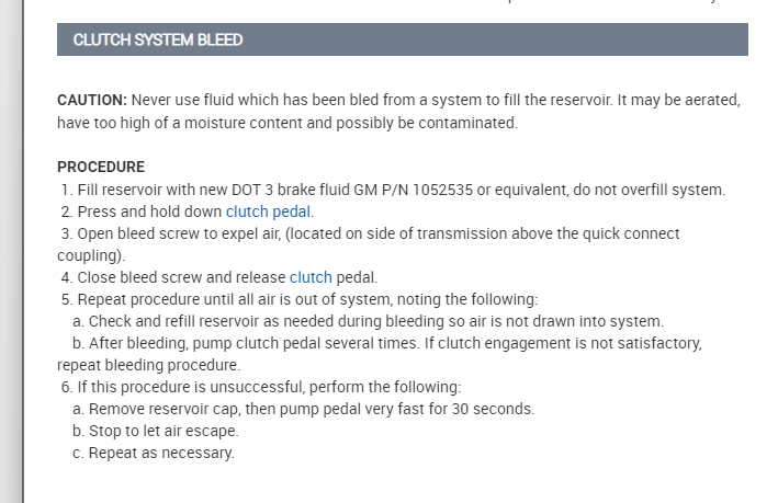

I replaced my clutch slave and can't seem to bleed properly. Can anyone help with the proper procedure? Thank you

I will attach the process below for this as it is not much different than bleeding the brake system.
Here is a guide on replacing the slave in case you need this info:
https://www.2carpros.com/articles/throw-out-bearing-replacement
Please see the attached info. If you are still having issues, then more than likely we have a defective part so let's start with this and go from there.
