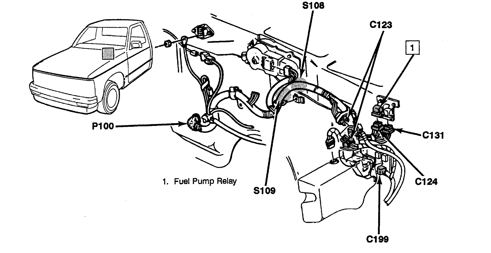

Here is the fuel pump relay located?
Sep 19, 2010 at 6:20 PM
RASMATAZ
CERTIFIED EXPERT
75,992 POSTS
Hello
The fuel pump relay is located on firewall, left of brake booster. HEre is a guide to help you test it with diagrams below to show the location.
Check out the diagrams (Below). Please let us know what you find.
