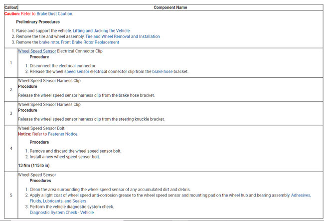

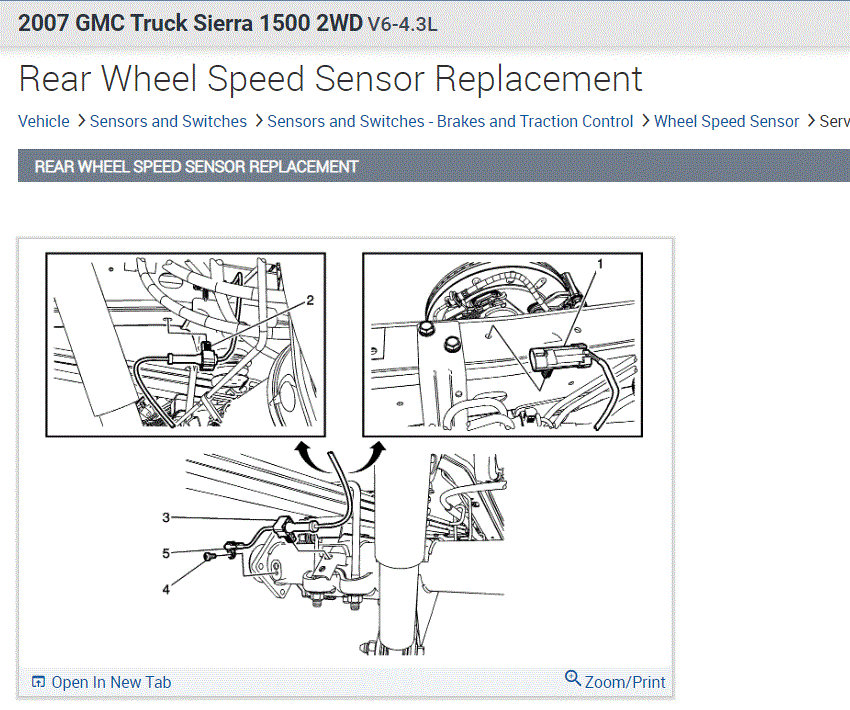

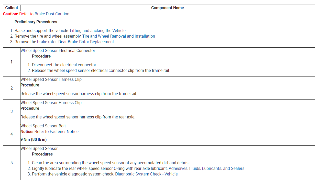

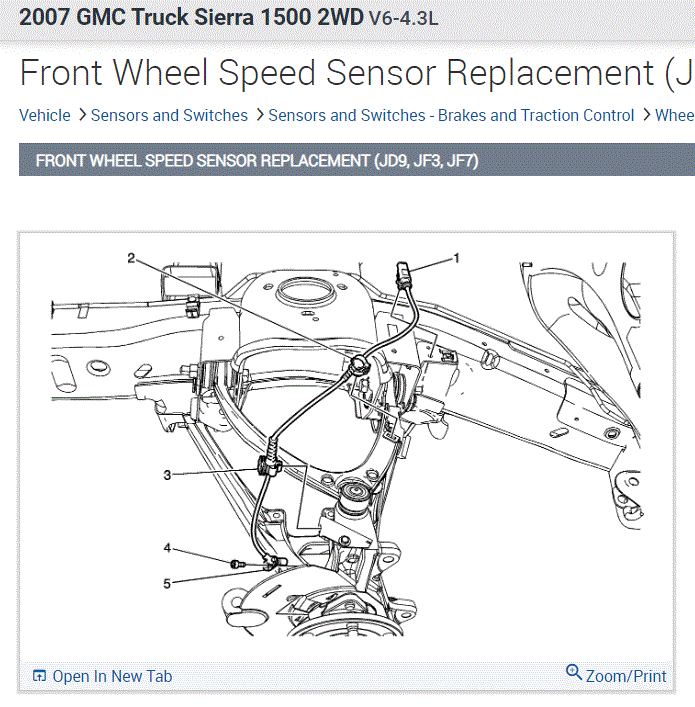

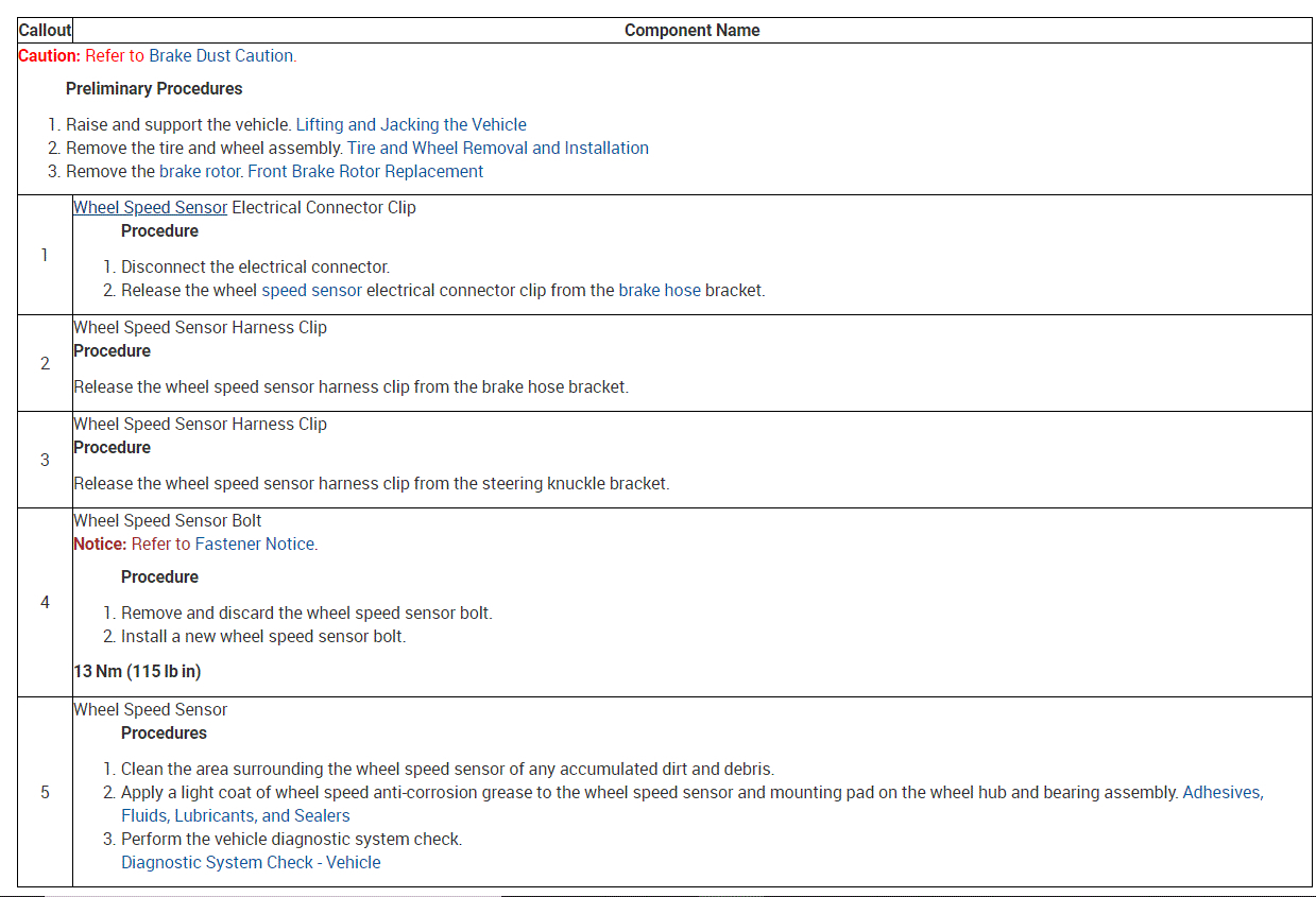

If you decide to replace one or more, the attachments below include the directions and pics specific to your vehicle for replacement. The first two pics are for a rear sensor. Pics 3 and 4 are for a front sensor.
I hope this helps. Let me know if you have other questions.
See pics below
