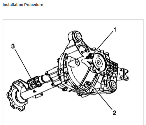

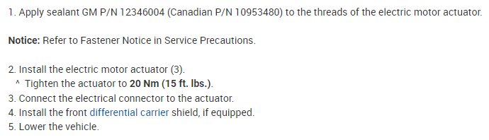

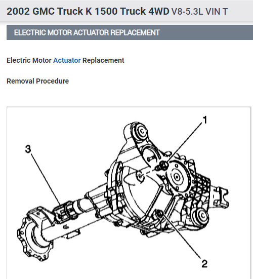

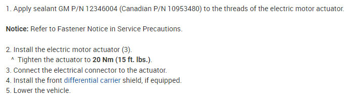

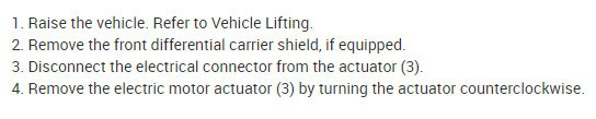

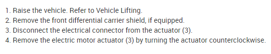

There is a common problem on these trucks with the front differential actuator failing. I've attached picture steps below on how to replace the front differential actuator on your GMC truck. Hope this helps and thanks for using 2CarPros.
