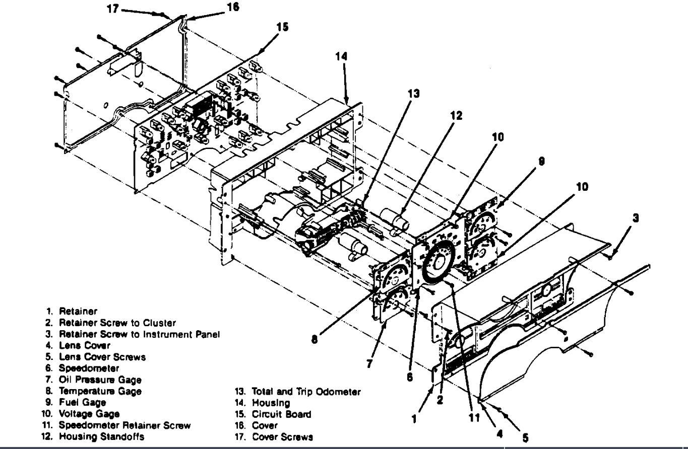

Looks like The Vehicle Speed Sensor Input Buffer is located in the Instrument Cluster on the Circuit Board.
See the diagram below for location
