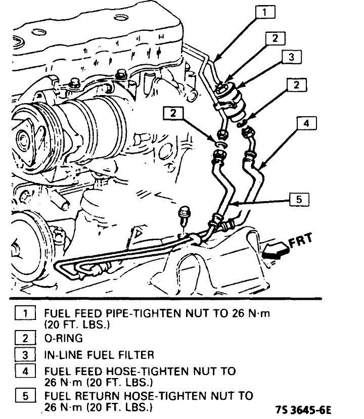

How about the fuel filter? ECM valve, what does that look like? And tell me all the parts you changed and why you changed them.
Dec 5, 2007 at 1:00 AM

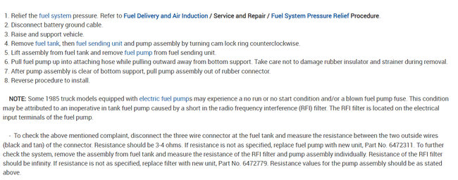

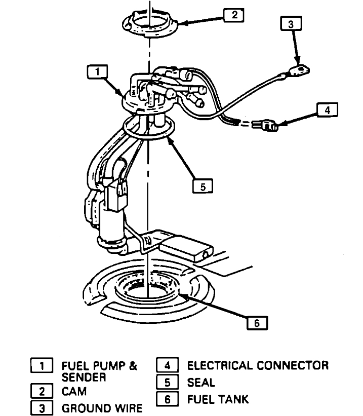

Yep, I was going to say the fuel pump in this trucks go out. Here is the location of the fuel pump and the fuel filter so you can swap them out which should fix the problem. Check out the images (below). Let us know how it goes
