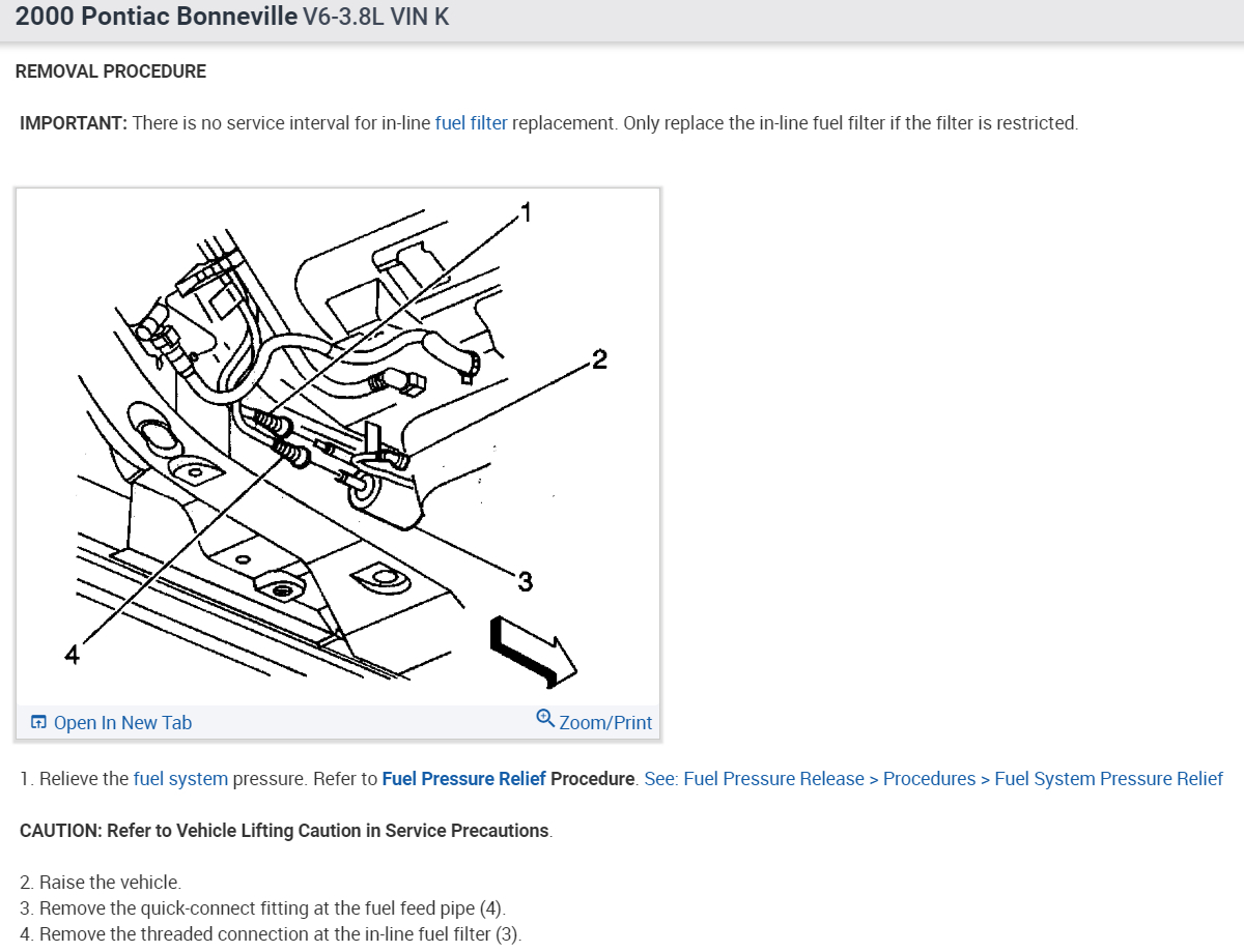

Where is the fuel filter located in a 2000 pontiac bonneville, 3800 series engine?

The filter is under the car on the driver's side near the tank here is a guide and a diagrams below to show the location on your car.
https://www.2carpros.com/articles/how-to-change-a-fuel-filter
Check out the diagrams (Below). Please let us know if you need anything else to get the problem fixed. Cheers

I'm saying that the filter is located in the middle of the car underneath. It is about 18" to 2 feet from the drivers edge of the car.
I was trying to save you some grief. The filter is under the car and hard to get to. It requires 2 different size line wrenches.
