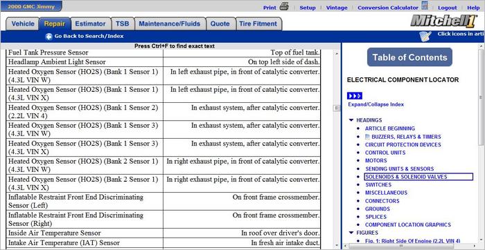

RICHARD GERIC
Where are the location of the four oxygen sensors?
Oct 3, 2020 at 1:25 PM (Merged)
RASMATAZ
  • 75,992 POSTS
Here is a guide to help you change out the oxygen sensor and the location of the sensors are below in the diagram.
https://www.2carpros.com/articles/how-to-replace-an-oxygen-sensor
Check out the diagrams (below). Please let us know if you need anything else to get the problem fixed.
