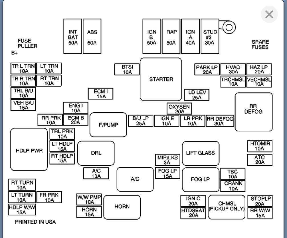

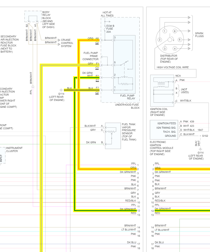

Where is the fuel pump fuse located??? Not the relay. i already know where that is, under the hood but i need to find the fuel pump fuse. my book says that it behind the glove box, but it not there. anyone know where its at?
Oct 3, 2010 at 2:22 PM

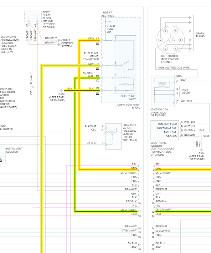

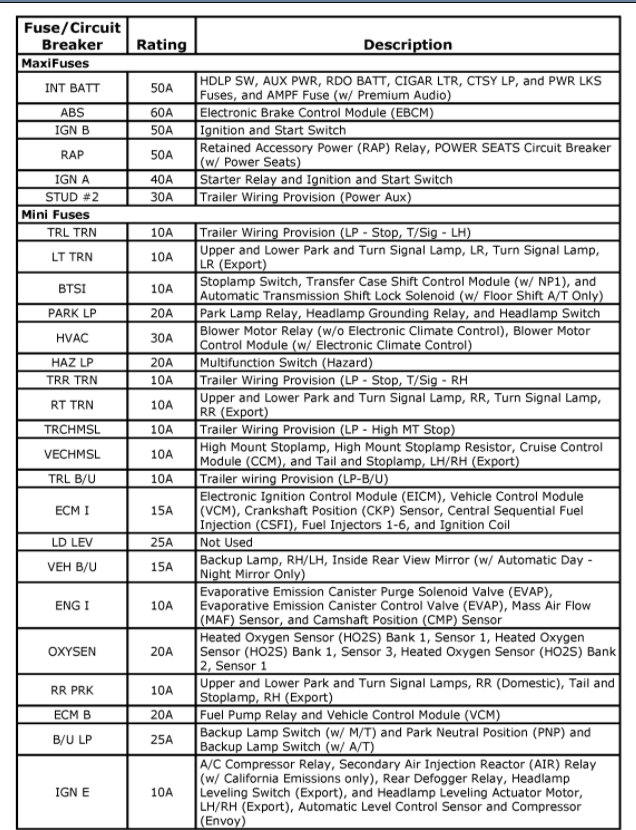

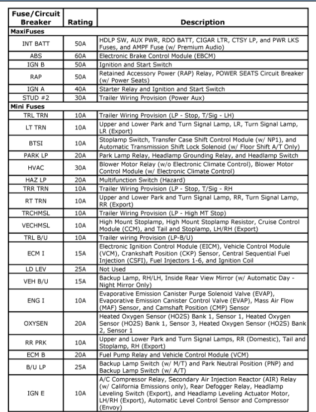

The fuse is in the under-hood fuse block. The fuse that powers the relay is the ECM B fuse which is a 20-amp fuse located right to the fuel pump relay.
Here is a guide that will help with testing the of the fuse if needed:

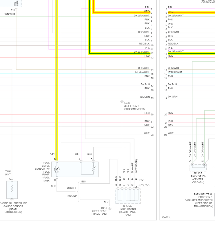

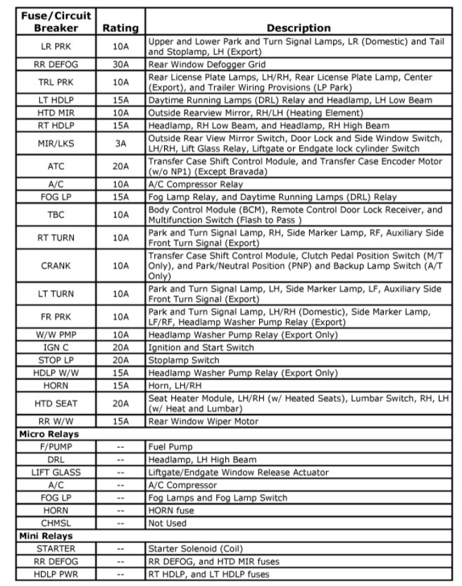

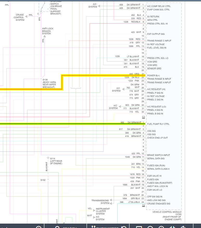

Please see the info attached below for the fuse and let us know what other questions you have.
