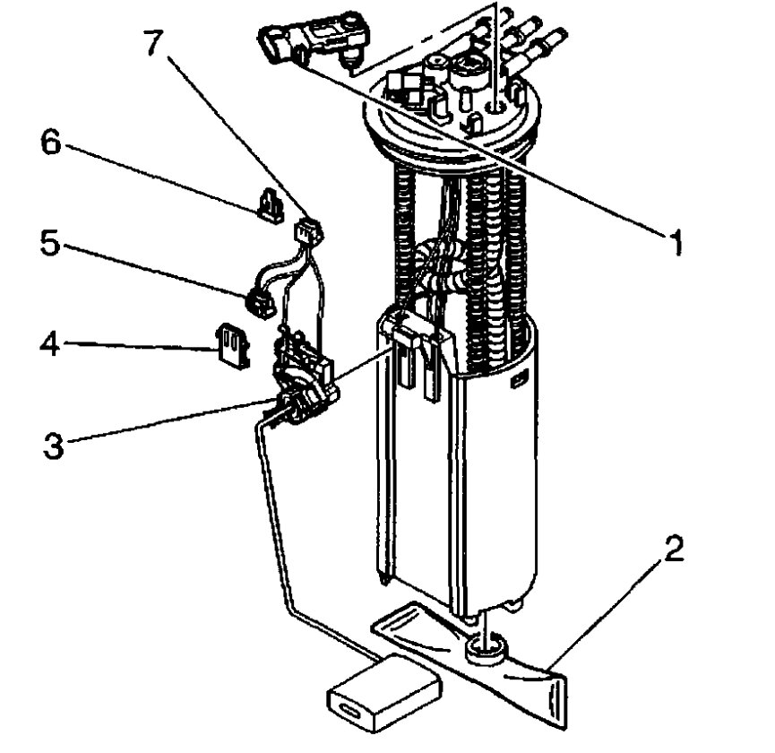

Just a tidbit, mine is a 2000 SLE a retired state vehicle. It's a little bit of a catch 22 but I was told by a State mechanic who used to work on these if the vehicle has been sitting for a while ( more than a week) if you don't hear the fuel pump when you turn the key on you have to get someone to sit in the driver seat and then then you have to climb underneath and as the person is cycling the key on and off, if you can get access to where the fuel pump is you take a wrench and very lightly tap on the fuel pump until you hear it on. I stress very lightly because as someone pointed out that there are fragile lines that you can break. Mine is a new pump so don't have the issue. This means do not go under there with a sledgehammer or jack hammer. A small wrench or screwdriver handle should do the trick but tap very lightly and make sure to add fuel first otherwise you will have to repeat. I would assume tapping on the fuel tank would work as well if you can't access the fuel pump. Mine I can get to the fuel pump, but it is a tight squeeze. Now my question there is sheet metal shield under the fuel pump, would I be safe removing this? I would think that it is for off roading to protect the tank, but I am not planning on doing any rock climbing. My only off roading will be in some farmers field as I am a volunteer firefighter, but my only job is directing traffic and unless they need me to direct cow traffic I might not be there either. I believe the only time would be on a search and rescue.
Feb 8, 2024 at 1:01 PM

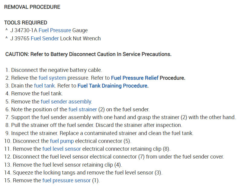

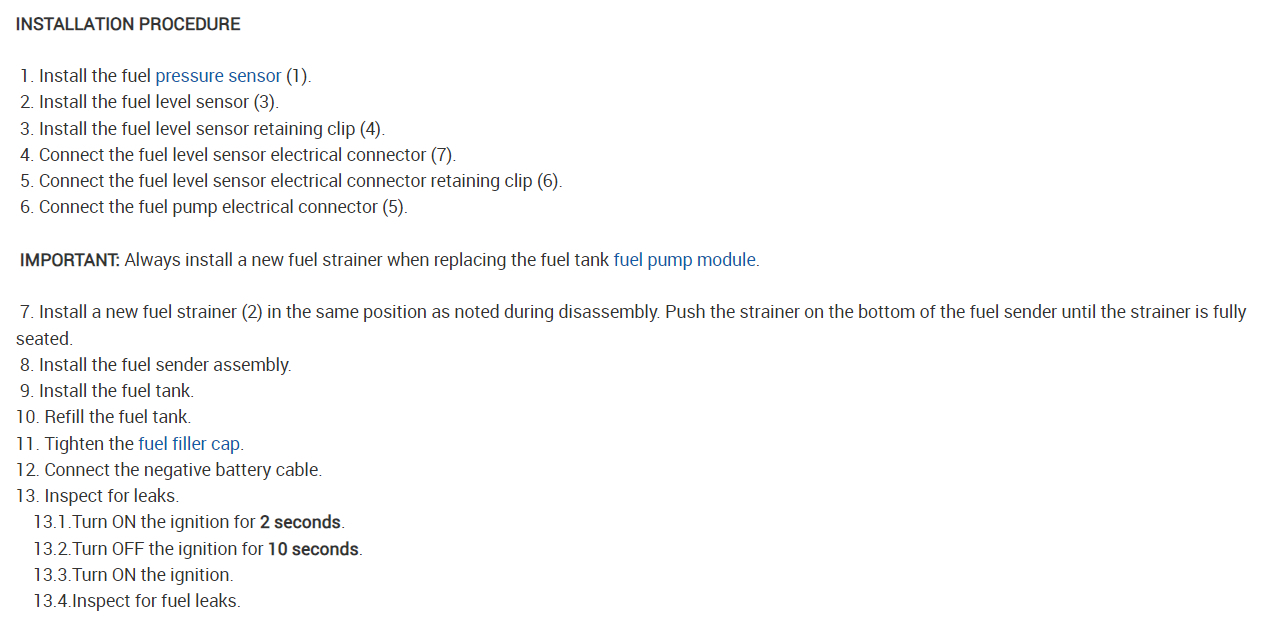

Yep, you should be okay, but I can tell you I would drop the tank and replace the fuel pump, one time the pump will not work even with tapping the fuel tank. Here is how to do the job is done in case you want to fix it:
https://youtu.be/bCcueO4ALxQ?si=0zIhliEyQYcLfuKv
