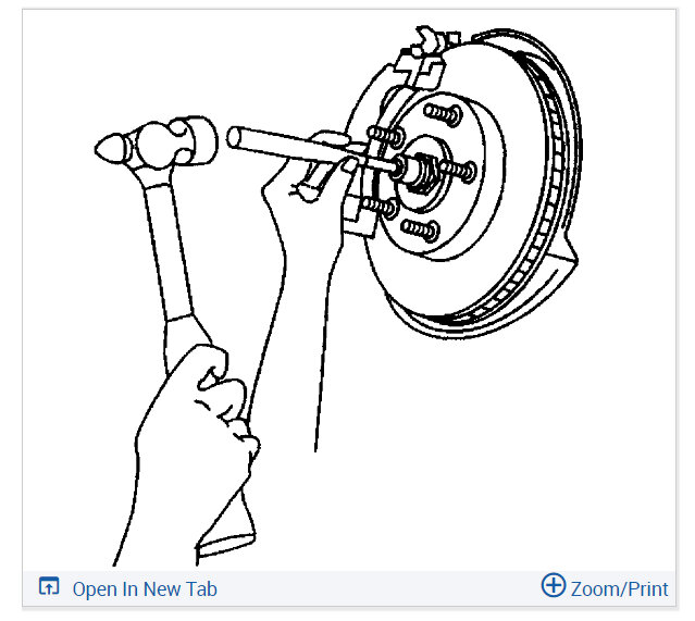

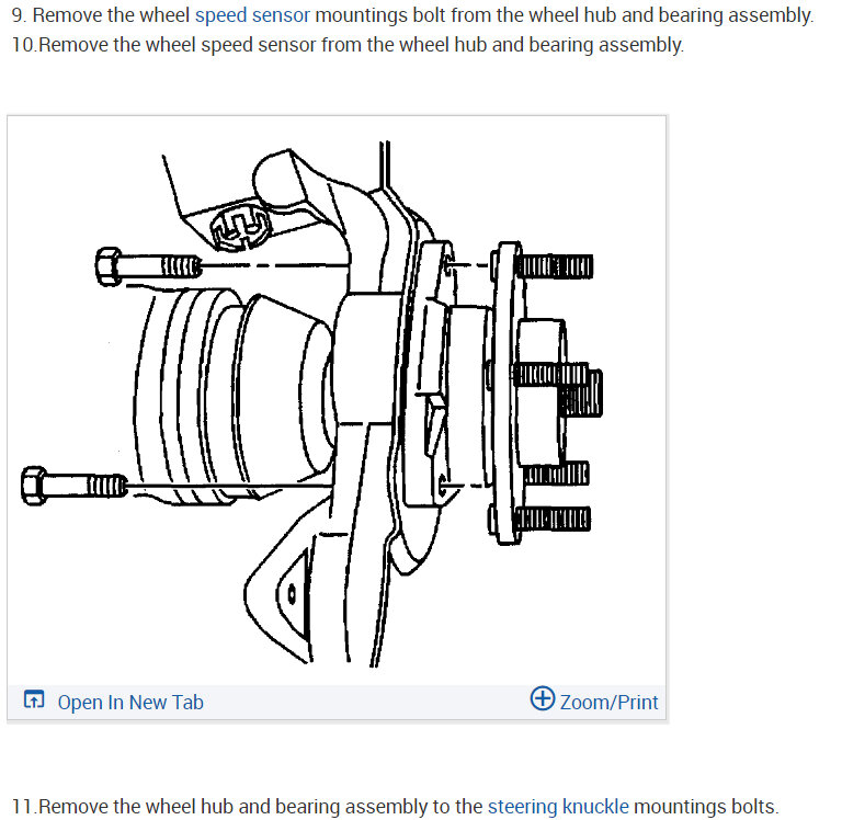

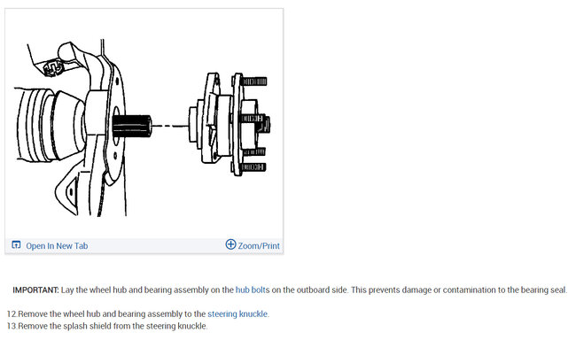

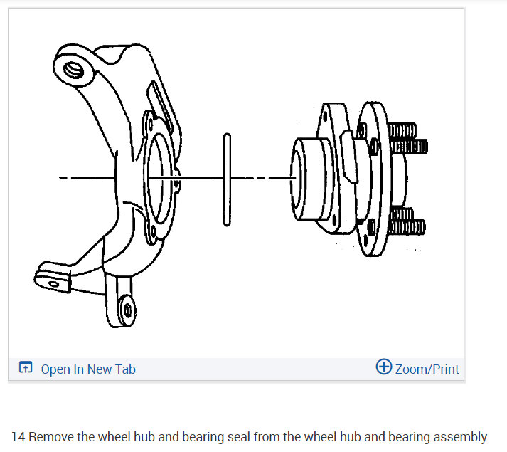

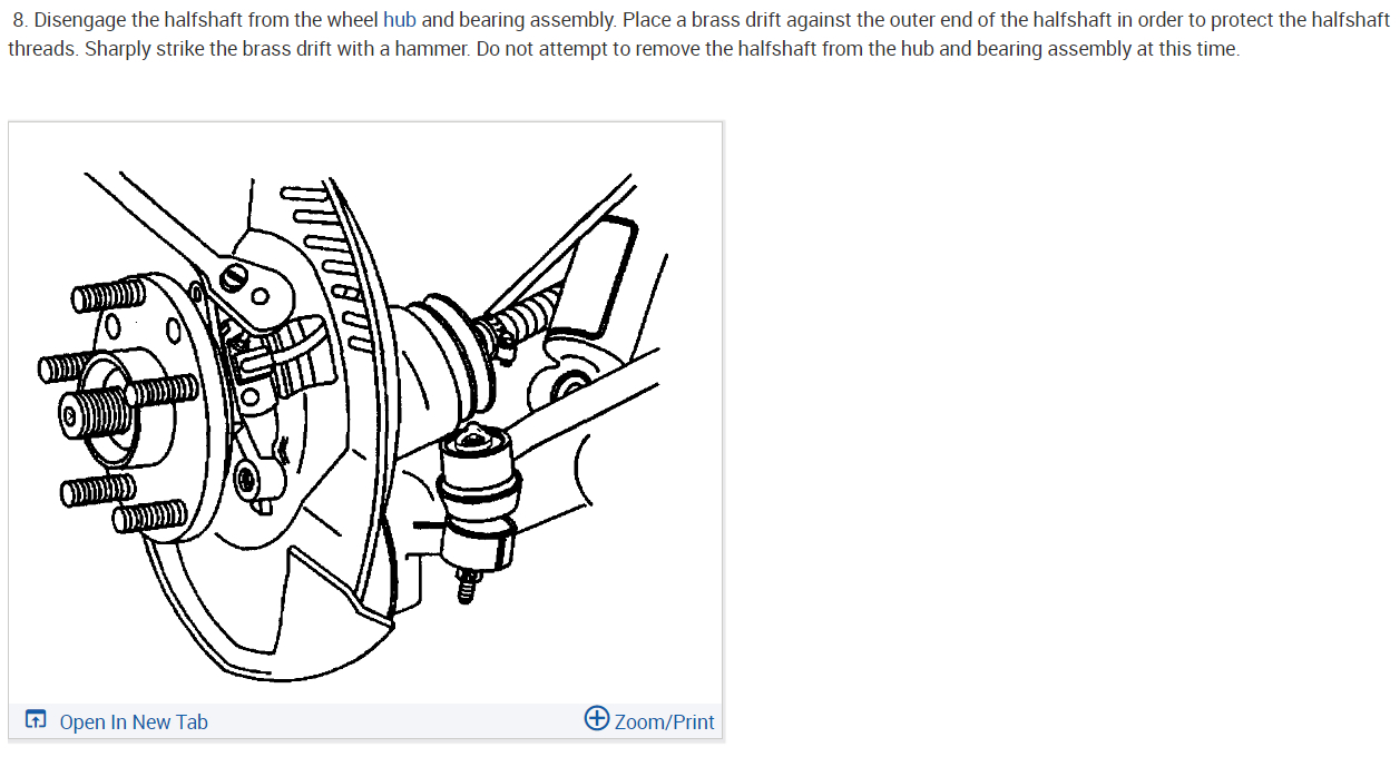

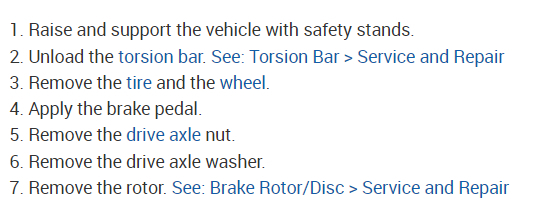

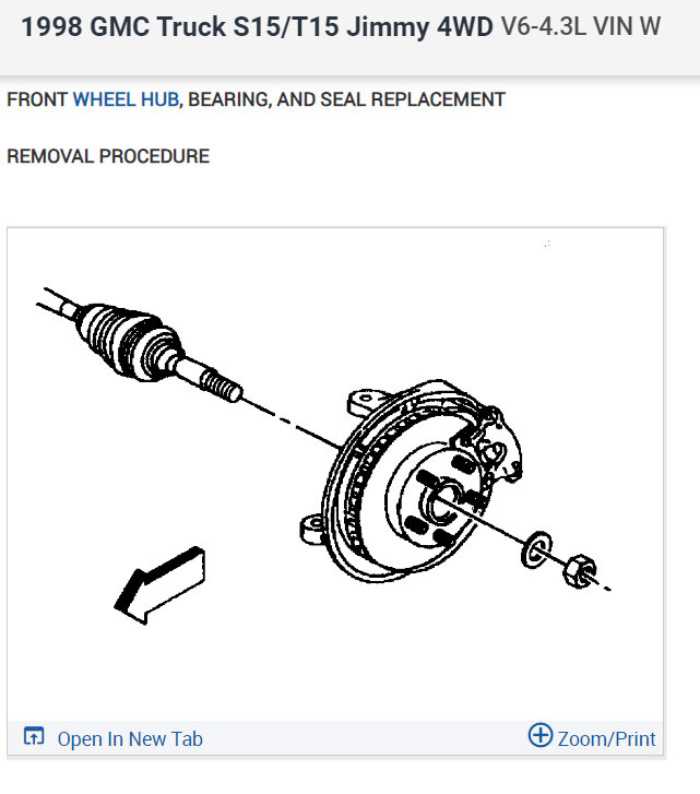

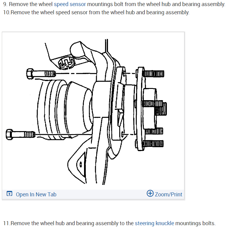

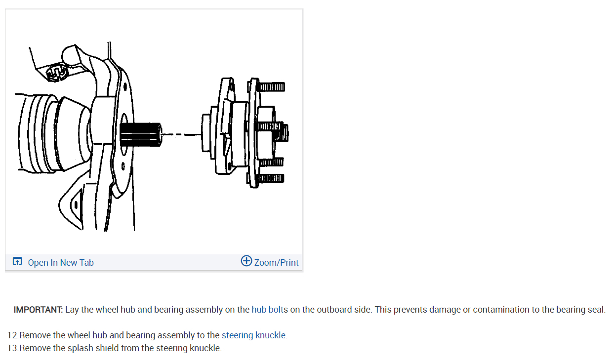

I have seen the bearing hub go out and cause this problem, raise the front of the car and spin the front wheel you will hear the noise.
this video shows how the job is done.
https://youtu.be/ZgiPRG6jffc?si=khWreQcMOCM1-HpA
Check the images below. Check out the images (below). Please let us know what happens.
