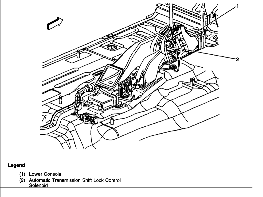

What happen is the interlock solenoid becomes weak and doesn't lift the lock from the gear selector. This can be checked with a test light and if the unit is getting power but not working it needs to be replaced.
Here is a guide that will help us get the problem fixed.
I have seen where the sifter cable becomes difficult to move causing a problem as well.
Please let us know what you find.
