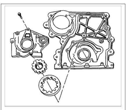

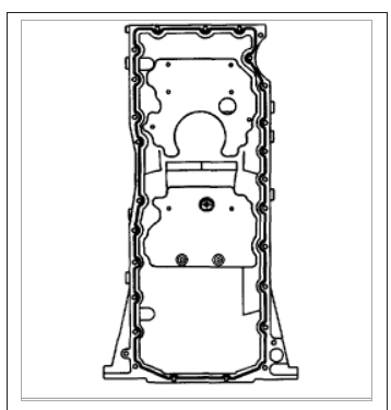

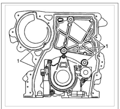

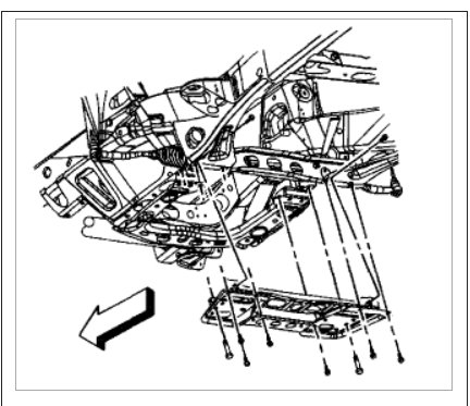

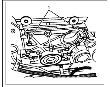

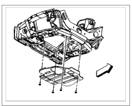

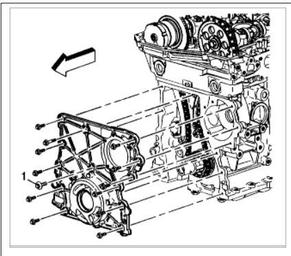

I would suspect a faulty oil pump. If pump starts to fail then there will not be enough oil to lubricate internal parts properly. Here are some diagrams (below) on how to do the job.
You will need to pull the front balancer and timing cover to get to the pump.
https://www.2carpros.com/articles/how-a-harmonic-balancer-works
Install the front cover bolts, tightening the center bolt last (1).
Tighten the front cover bolts to 10 Nm (89 inch lbs.)
I would check the oil pump pick up as well because if there is a sludge in the engine it will plug the inlet to the oil pump.
