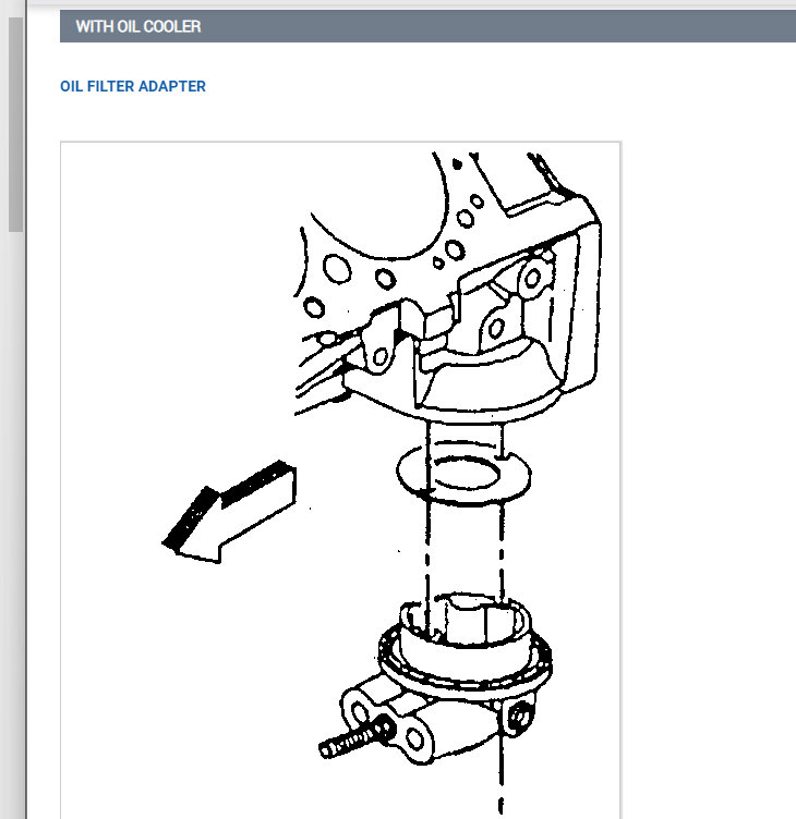

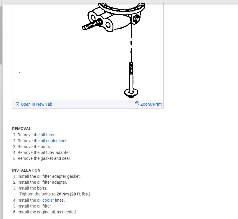

I am attaching the info from the manual but there will be two bolts on the bottom of it. I am not sure about this one but normally they are a different style bolt head and not just a regular bolt as they don't want them removed unless intended and if the bolt is like an Allen head, then they are left alone unless you mean to remove them.

Please see the info attached to show the location of these bolts. Let us know what questions you have.

Thanks - got it removed.
Those two things I called "metal caps" just happened to be Allen Heads - with the right key the housing dropped out like butter.
