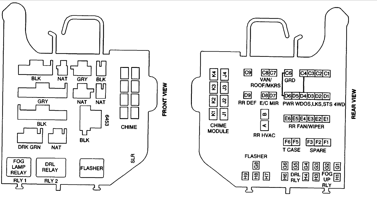

The flasher is located in the fuse panel under the dash here is a diagram (below) to help you see. FYI
Use 2CarPros anytime, we are here to help. Please tell a friend.
