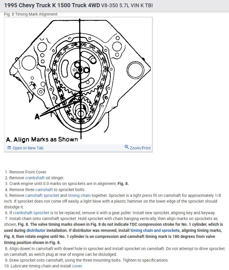

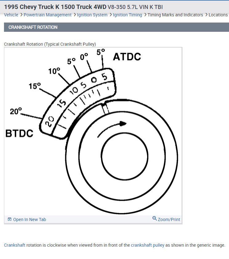

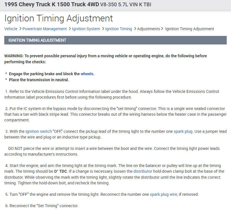

I recently replaced the upper intake gaskets and set the timing to 0 degrees btc and then set the distributor in at the number one. did I do this process right or did I leave something out. If I am off the truck should still start right.
