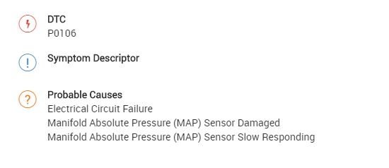

I attached the possibilities for you. Did you verify power to the mass air flow sensor?
https://www.2carpros.com/articles/how-to-replace-a-mass-air-flow-sensor-maf

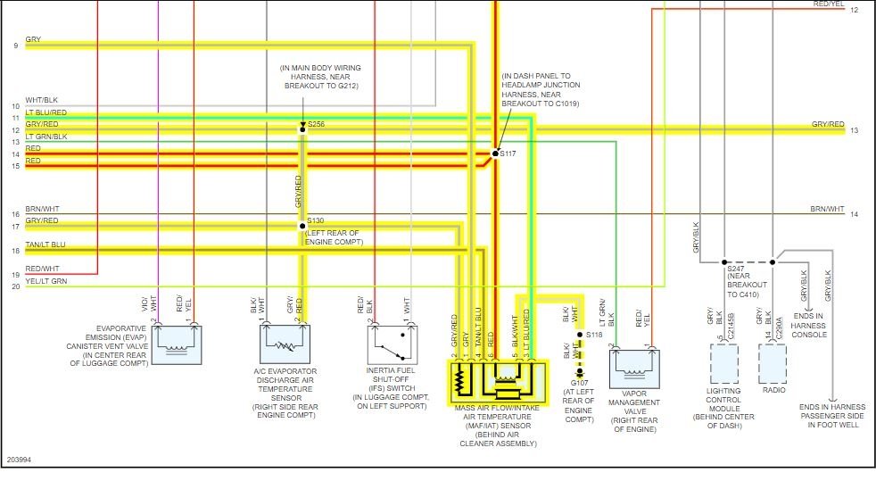

I also attached a wiring diagram for you. Do you have a voltmeter to do some testing at the mass air flow?

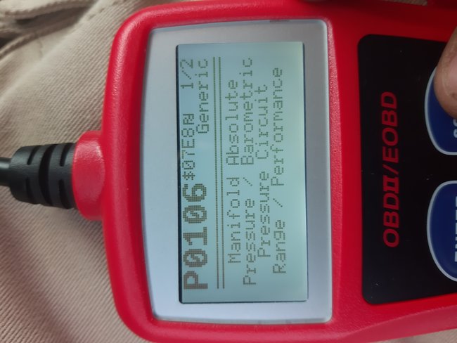

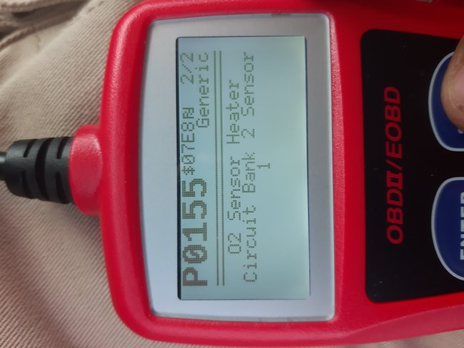

These are the codes that are reading right now.
Jul 16, 2020 at 4:18 PM

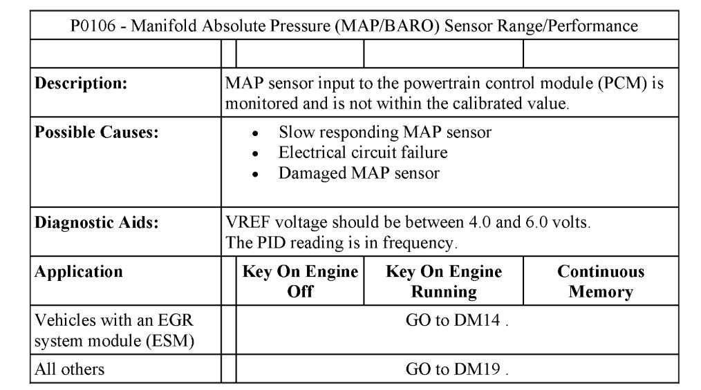

Okay, I attached the pin point test for the 106 code below.
The 155 is for the heater circuit for the O2 sensor. Make sure it has 12 volts with the key on.
pin point test for 106
DM: Manifold Absolute Pressure (MAP) Sensor
DM: Introduction See: Computers and Control Systems > Diagnostic Trouble Code Tests and Associated Procedures > DM: Manifold Absolute Pressure (MAP) Sensor - Introduction
DM1 MONITOR THE MAP_V PID
Key ON, engine running.
Carry out the KOER self-test.
Access the PCM and monitor the MAP_V PID.
Is the voltage between 0.05 - 4.95 V?
Yes
VERIFY the PCM is at the latest calibration level. REPROGRAM if necessary.
Otherwise, the fault is not present at this time.
No
Key in OFF position.
GO to DM2.
DM2 VERIFY HARNESS AND CONNECTOR INTEGRITY
ESM connector disconnected.
Carry out a thorough visual inspection of the connector, pins and wires attaching to the pins.
Are there any concerns with the wiring or the ESM connection?
Yes
REPAIR as necessary.
No
GO to DM3.
DM3 MONITOR THE MAP_V PID
ESM connector connected.
Key ON, engine OFF.
Yes
The fault is not present at this time.
No
GO to DM4.
DM4 DETERMINE THE PRESENT MAP_V PID VOLTAGE
Is the voltage less than 0.05 V?
Yes
GO to DM5.
No
GO to DM8.
DM5 KOEO AND KOER DTC P0107: CHECK THE VOLTAGE BETWEEN THE VREF AND SIGRTN AT THE ESM SENSOR
Key ON, engine OFF.
Measure the voltage between:
Is the voltage between 4 - 5.5 V?
Yes
GO to DM6.
No
GO to C1 See: Computers and Control Systems > Pinpoint Tests > C: Reference Voltage - Pinpoint Test.
DM6 CHECK THE MAP CIRCUIT FOR A SHORT TO SIGRTN AND GND IN THE HARNESS
PCM connector disconnected.
Measure the resistance between:
Is the resistance greater than 10K ohms?
Yes
GO to DM7.
No
REPAIR the short circuit.
DM7 INDUCE THE OPPOSITE MAP SENSOR VOLTAGE TO SIMULATE HIGH CONDITION
PCM connector connected.
Connect a 5 amp fused jumper wire between the following:
Key ON, engine OFF.
Is the voltage greater than 4.6 V?
Yes
Key in OFF position. INSTALL a new ESM.
CLEAR the DTCs and REPEAT the self-test.
No
Key in OFF position. INSTALL a new PCM.
REFER to Section 2, Flash Electrically Erasable Programmable Read Only Memory (EEPROM) See: Computers and Control Systems > Diagnostic Trouble Code Tests and Associated Procedures > Flash Electrically Erasable Programmable Read Only Memory (EEPROM).
