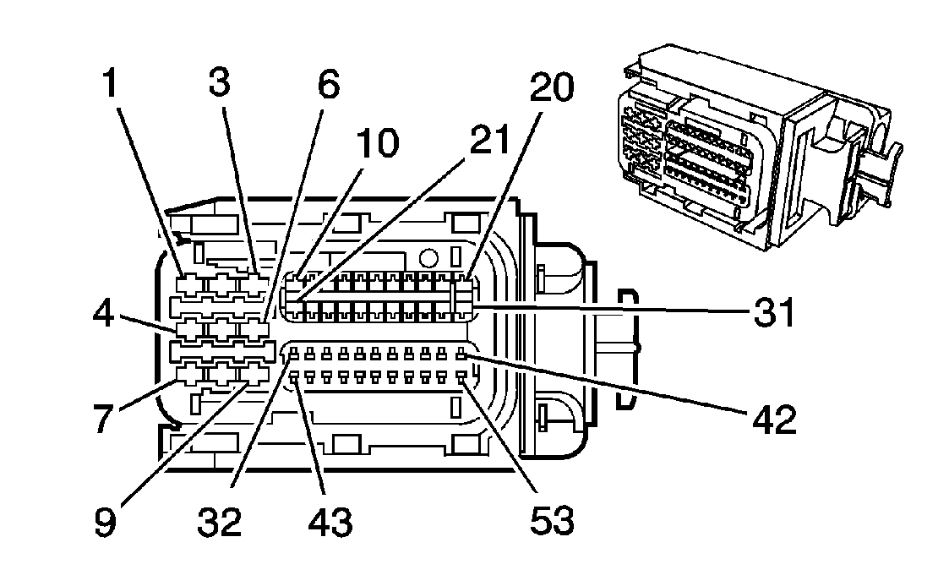

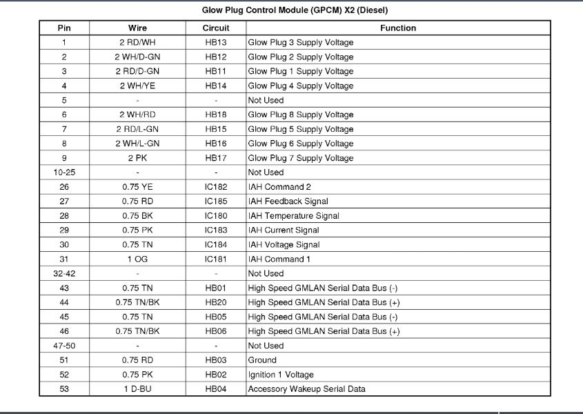

The glow plugs are controlled by PWM or pulse width modulated signal. You will get no reading from a voltmeter with this check.
Check the wire from number 2 back to the controller and make sure it is not open. If the wire is intact then good chance the controller failed from the glow plug failure.
Yes, it has to be programmed as it is a module with serial data lines.
Check the wire first. I attached a connector diagram for you to view. Verify your powers to the module. There are 2.

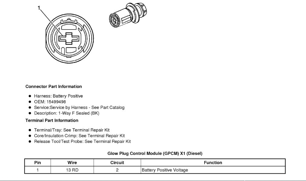

Did you verify both powers to the module?

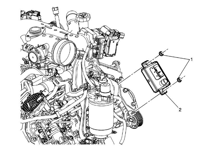

So my glow plug light came on this morning. I have not found the second power module just the one below passenger side valve cover.
Dec 2, 2019 at 12:46 PM
There is only 1 module. There are 2 power wires on the module. Check the diagrams I already posted for the power wires.
