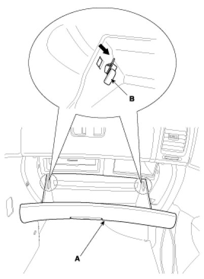

How do I remove the glove box?

Open the door on the box. There are two tabs in the rear that snap free but they are a bear to get free because you need to almost close the door while you push the tab in and twist it so you can pull it into the box. Then the door can drop down so you can remove the lift arm and door pins.
