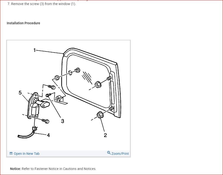

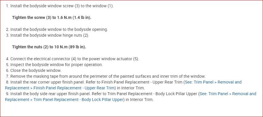

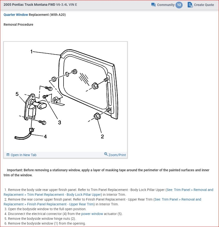

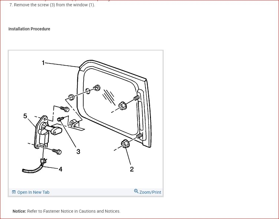

How to remove rear power quarter glass?

Hi Rickey,
Here is the procedure to remove the quarter glass. Please let me know if you need anything else. Check out the diagrams (Below). Please let us know if you need anything else to get the problem fixed. Thanks
