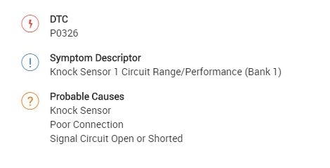

The 326 is for the knock sensor. There is not much in diagnostics for this as they tell you to replace it and see if it goes away.

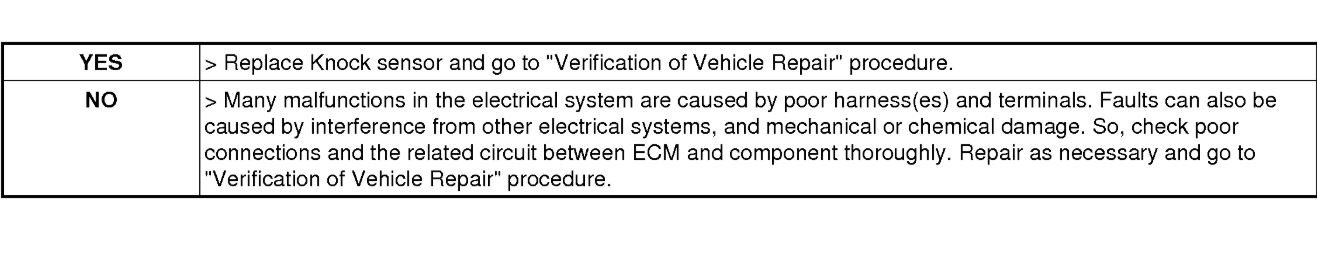

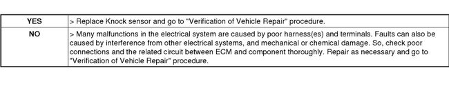

1. Substitute with a known - good Knock sensor and check for proper operation.
2. Is the signal normal?

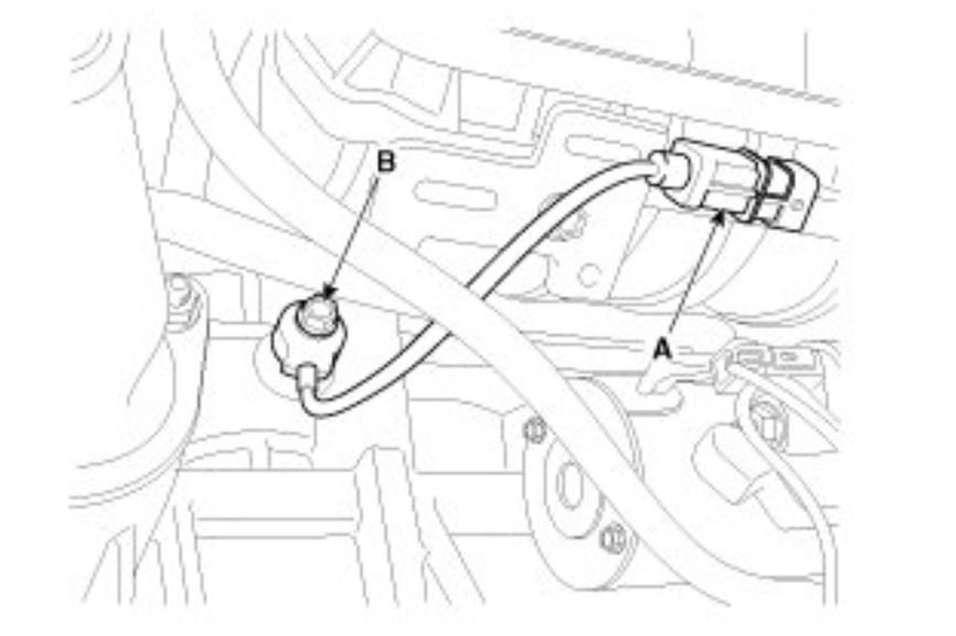

Removal
1. Turn the ignition switch OFF and disconnect the battery negative (-) cable.
2. Remove the intake manifold .
3. Disconnect the injector connector (A).
4. Remove the installation bolt (B), and then remove the sensor from the cylinder block.
Installation
CAUTION:
Install the component with the specified torques.
Note that internal damage may occur when the component is dropped. If the component has been dropped, inspect before installing.
1. Installation is reverse of removal.
Knock sensor installation bolt:
18.6 - 24.5 N.m (1.9 - 2.5 kgf.m, 13.7 - 18.1 lb-ft)
