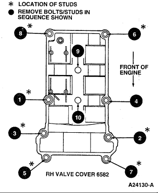

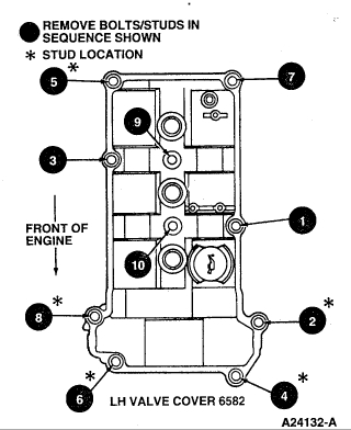

Loosen valve cover retaining bolts and stud bolts following the removal sequence shown.
Carefully remove valve cover from cylinder head. Remove integral valve cover gasket from valve cover.

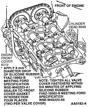

NOTE: Tighten all fasteners within six minutes of applying sealer or sealer will begin to cure and may not seal properly.
Install new valve cover gasket onto valve cover.
Apply 8 mm (0.31 inch) diameter bead of Black Silicone Rubber F4AZ-19562-B or equivalent sealant meeting Ford specification WSF-M4G323-A1 at two places on the valve cover sealing surfaces where the engine front cover and cylinder head contact.
Tighten valve cover bolts and stud bolts in sequence shown to 8-12 Nm (71-106 inch lbs.) within six minutes of applying sealer.

I've attached pictures of the tightening sequence for you as well as what you will find once removed.

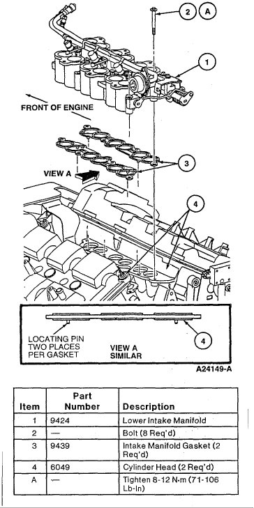

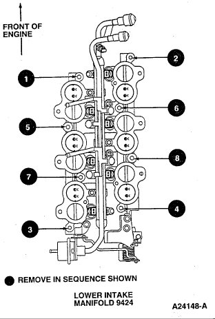

Once you have things apart, make sure to check the intake gasket for leaks as well. If you find a leak, here are the directions from alldata to remove and replace the components. I've also attached pictures for guidance.

If required, remove fuel injection supply manifold and fuel injectors from lower intake manifold (IMRC).
Remove lower intake manifold to cylinder head retaining bolts in sequence shown.
CAUTION: Do not loosen or damage intake manifold runner control actuator cable retainer bracket.
Remove lower intake manifold (IMRC) from cylinder heads.
Remove intake manifold gaskets from cylinder heads and discard intake manifold gaskets.
