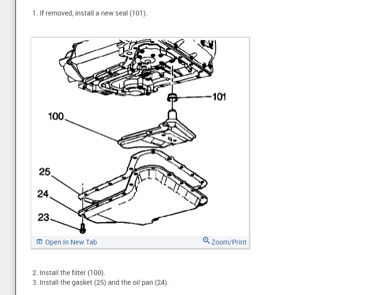

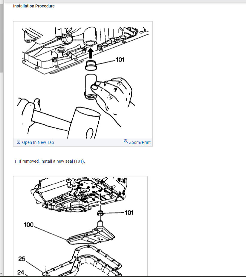

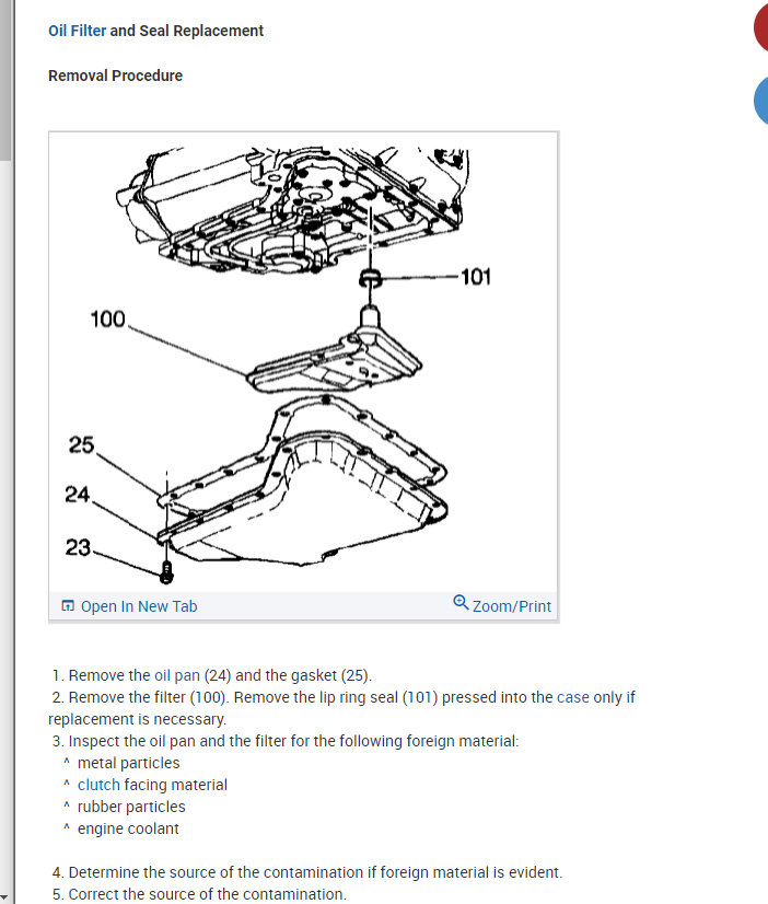

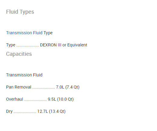

I will attach the specific info below on what fluid and how much to use. However, here is a guide that will help with replacing the fluid and filter:

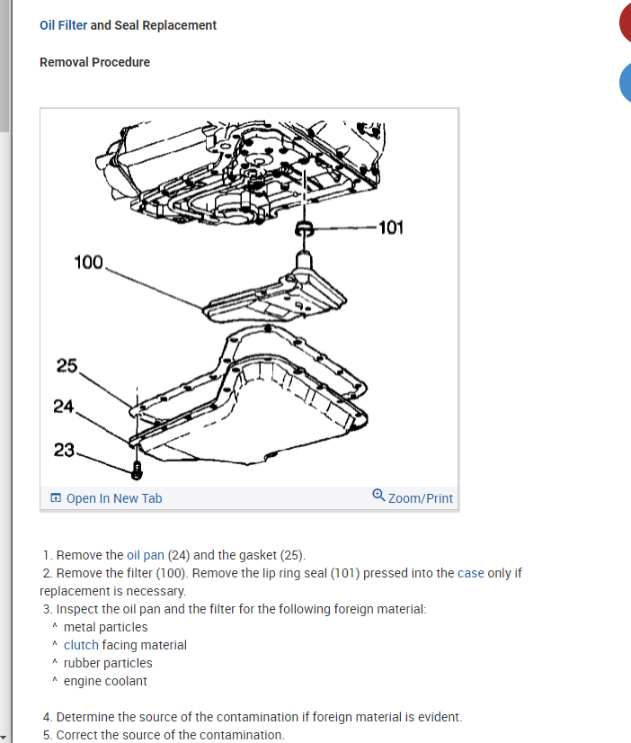

I am attaching the info below on how to change the filter as well from the manual.
Please run through this material and let us know what questions you have. Thanks
