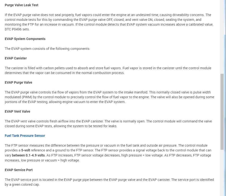

Yeah. That is pretty typical of a purge valve that is stuck. What happens is when you are adding fuel to the tank it is kicking up a lot of vapor normally. This vapor is normally kept in the tank and then when it gets enough it is pushed over to the EVAP system. When it goes in the purge valve is normally closed, however when it get stuck open this allows that vapor into the engine and it actually floods it out because the PCM is actually dumping the normal amount of fuel plus this vapor and it is too much.
Clearly we need to check this first and go from there.

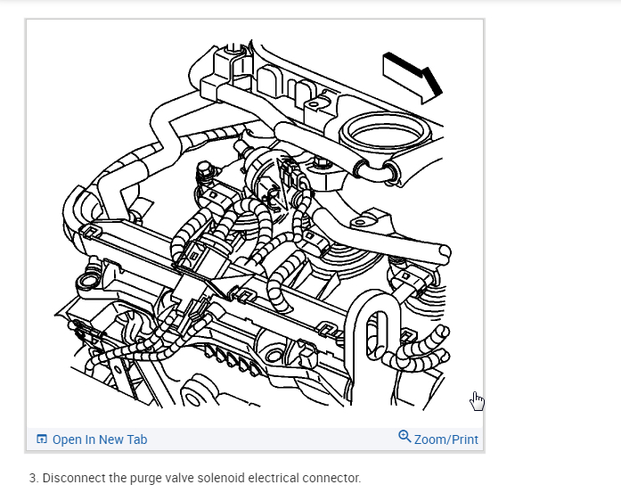

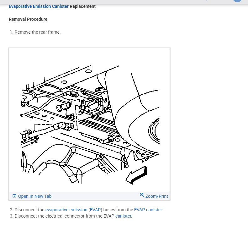

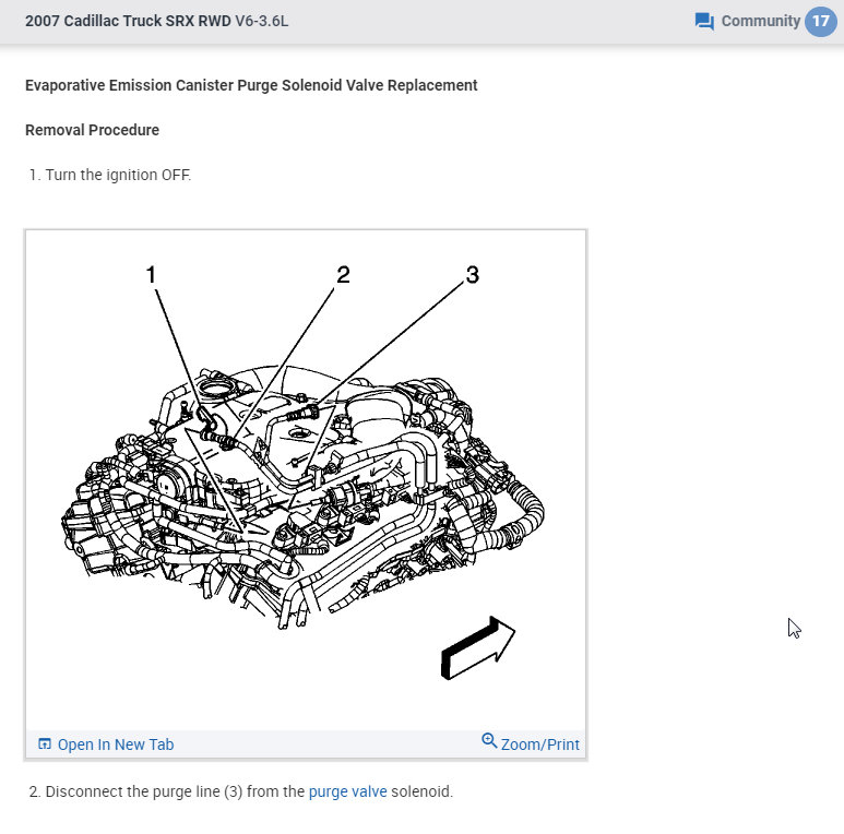

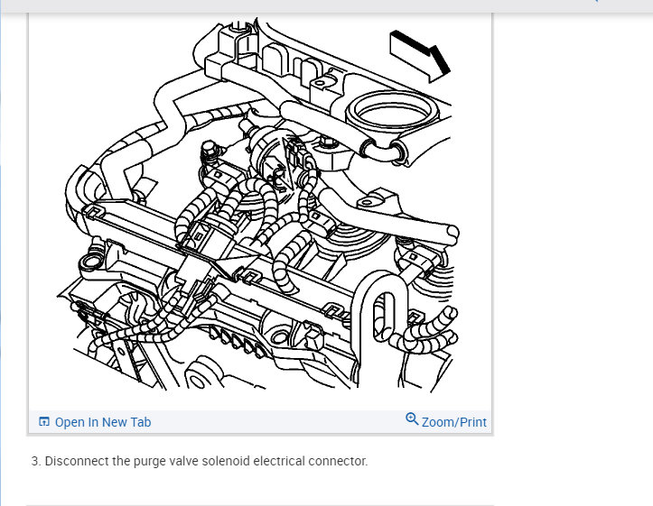

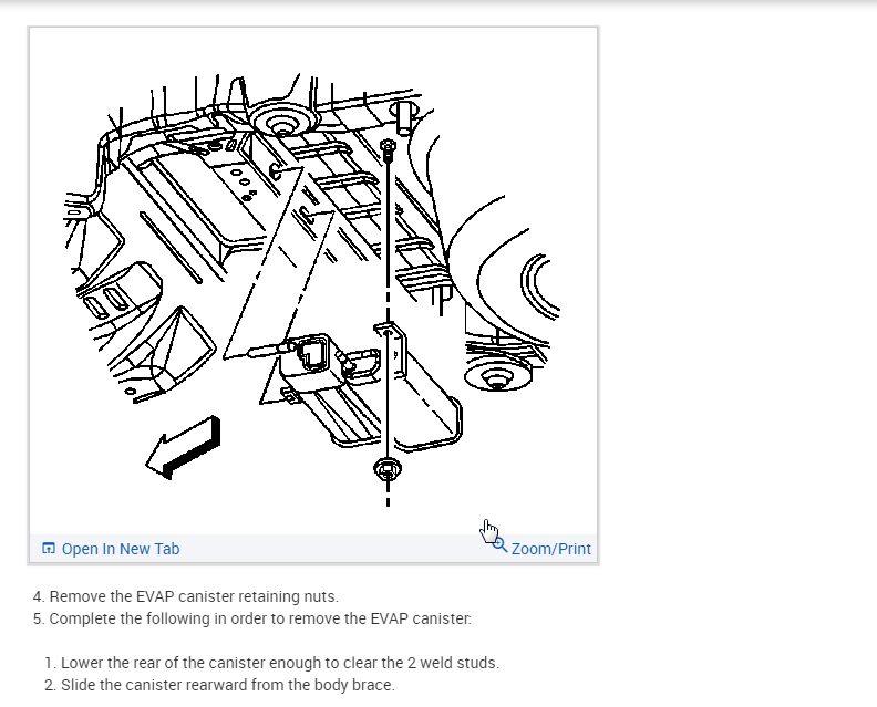

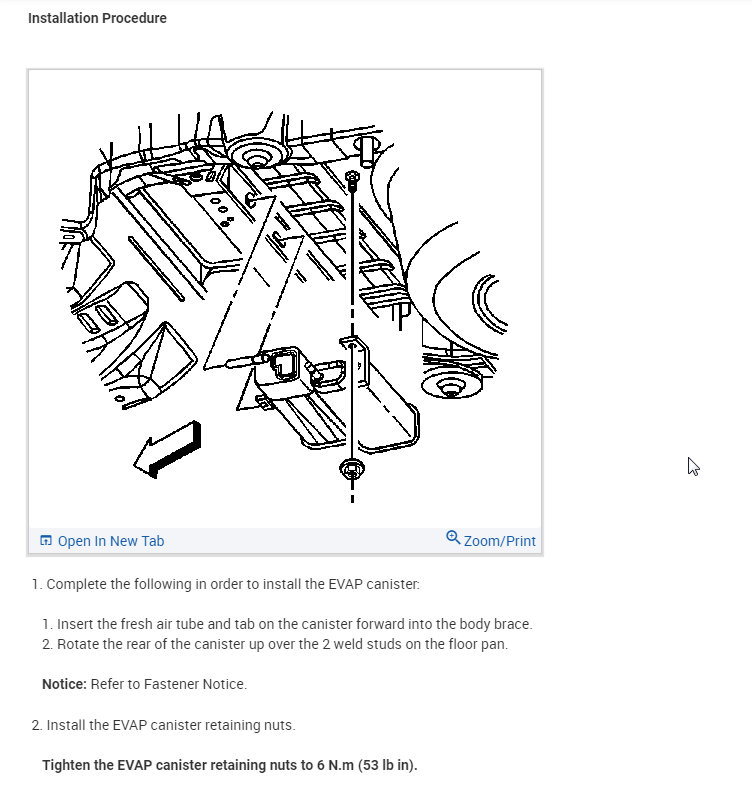

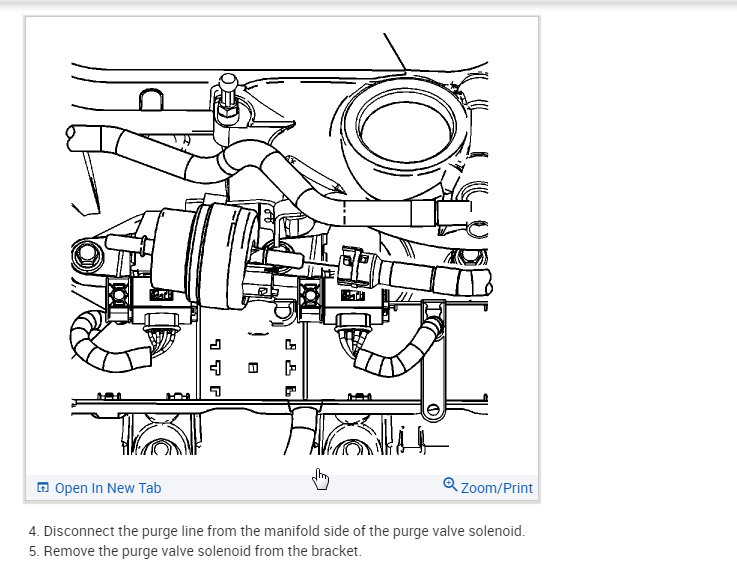

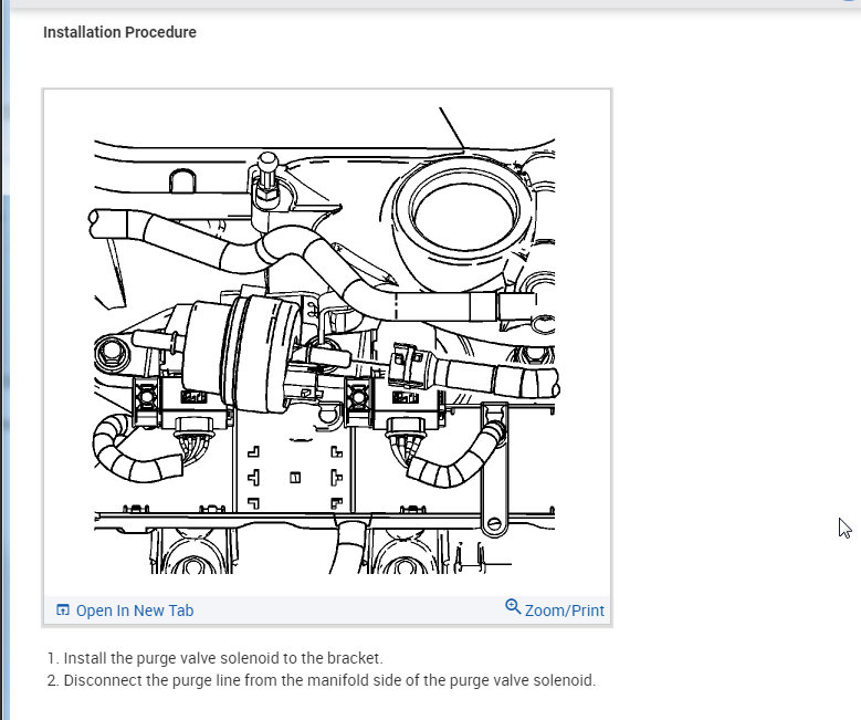

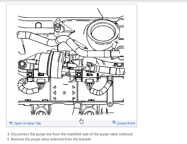

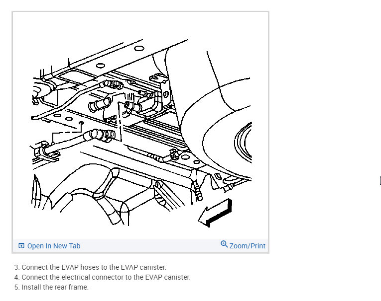

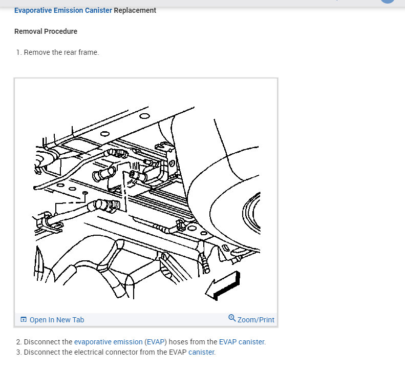

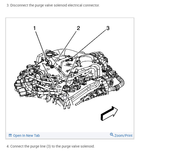

Do you know where that is located?
Mar 23, 2020 at 2:33 PM
Sorry. I meant to attach the process for both the solenoid and canister. Here they are:
Mar 23, 2020 at 2:45 PM
