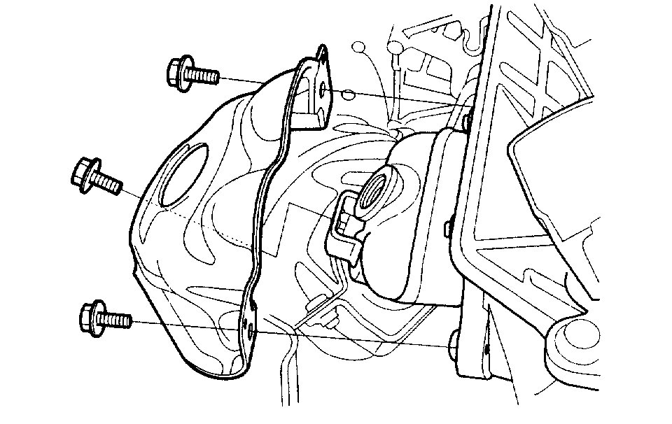

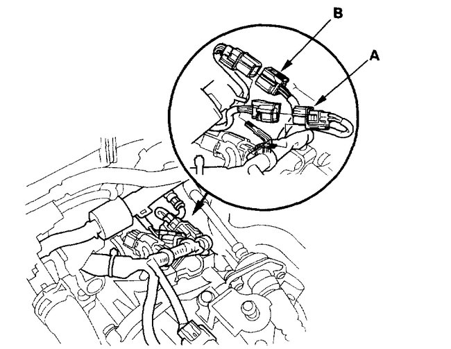

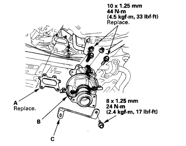

I attached a picture showing the converter (Pic 1). It is right off the exhaust manifold. Check for the noise coming from there. If you determine the converter is the problem, here are the directions for removing and replacing it.

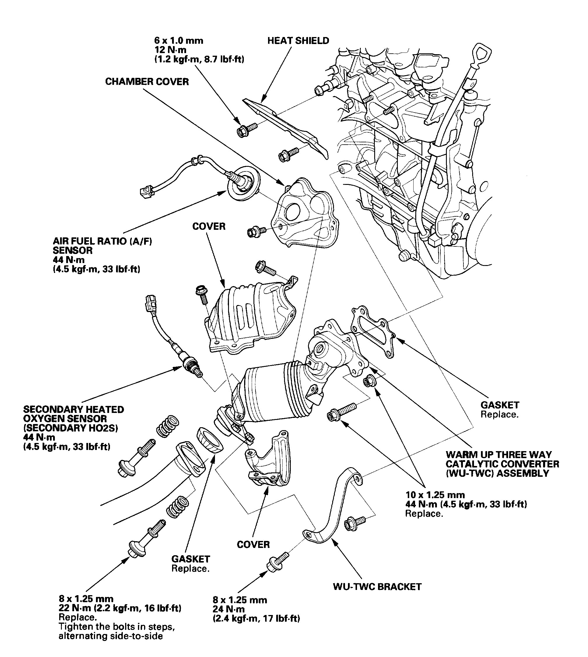

Picture 2
Removal

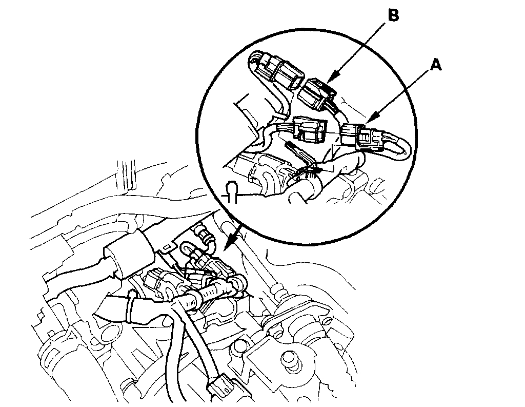

1. Remove the engine cover.

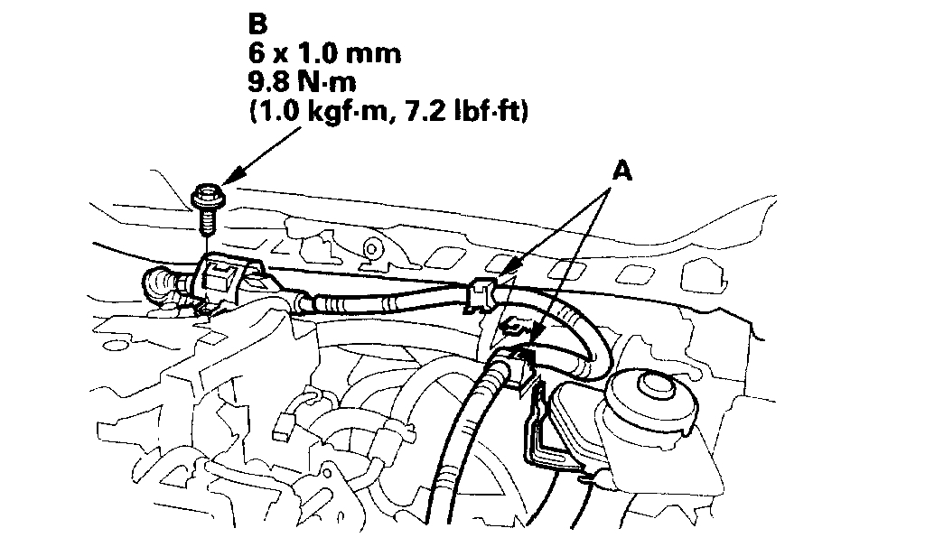

2. Remove the IMA power cable clamps (A) and the bolt (B).

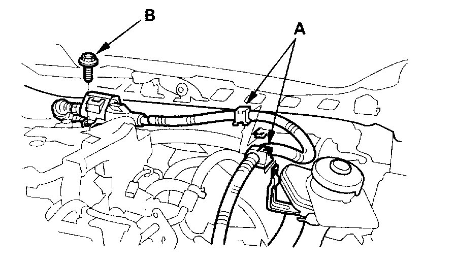

Picture 3
3. Remove the cowl cover.

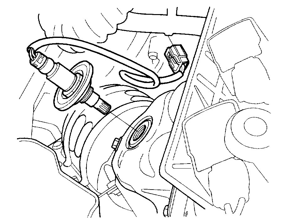

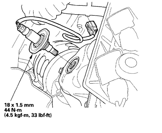

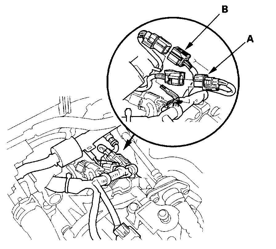

4. Disconnect the air fuel ratio (A/F) sensor connector (A) and the secondary heated oxygen sensor (HO2S) connector (B).

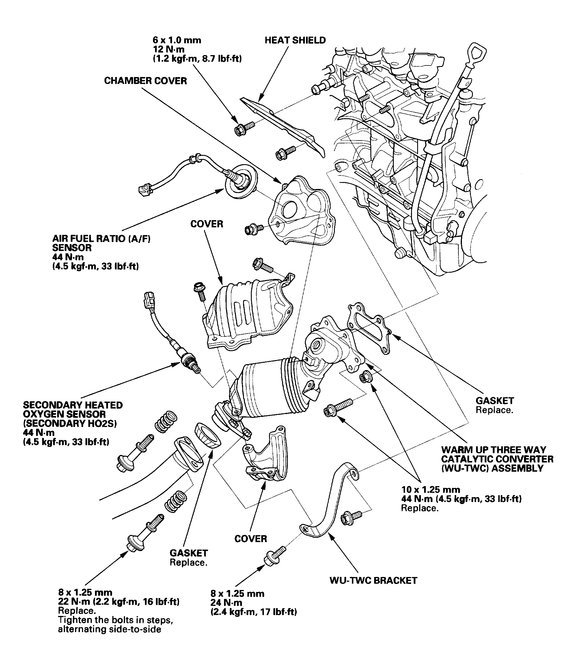

Picture 4

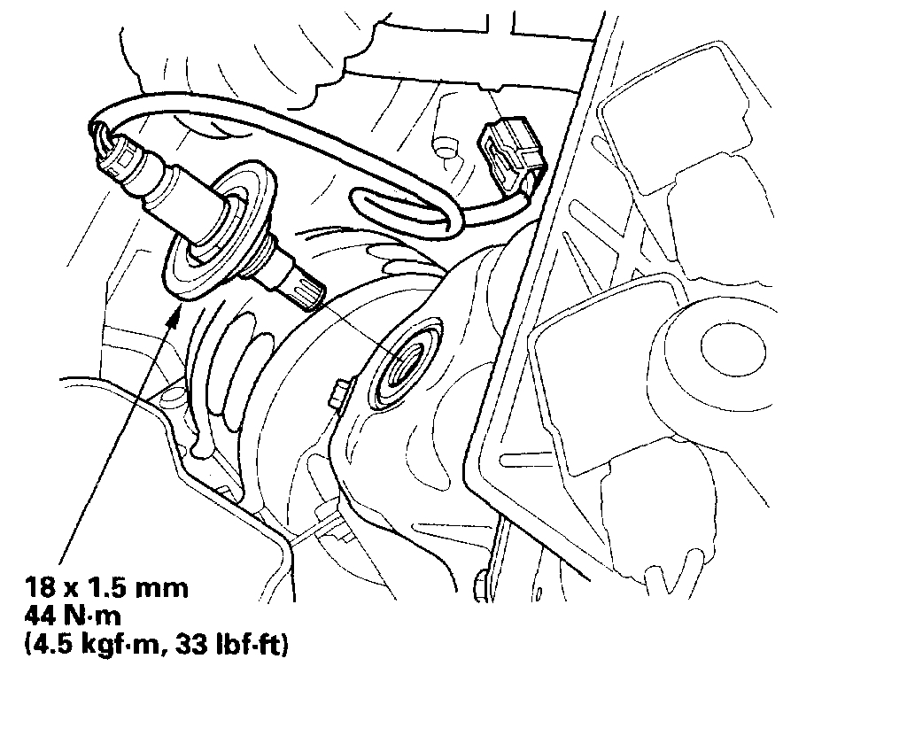

5. Remove the A/F sensor.

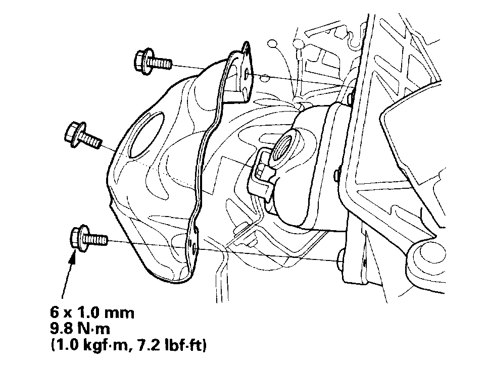

Picture 5
6. Remove the chamber cover.

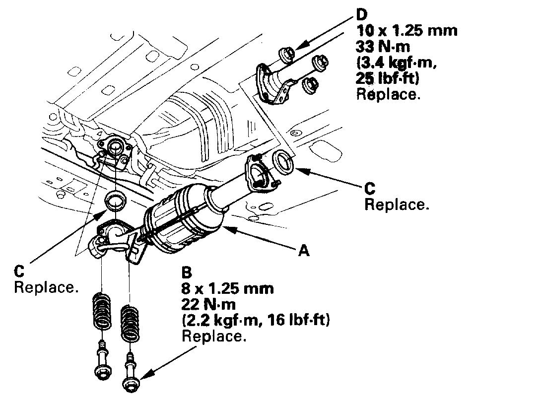

Pic 6
7. Raise the vehicle on the hoist to full height.
8. Remove the front wheels.
9. Remove the engine undercover and the splash shield.

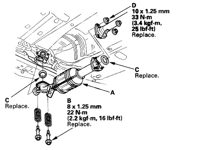

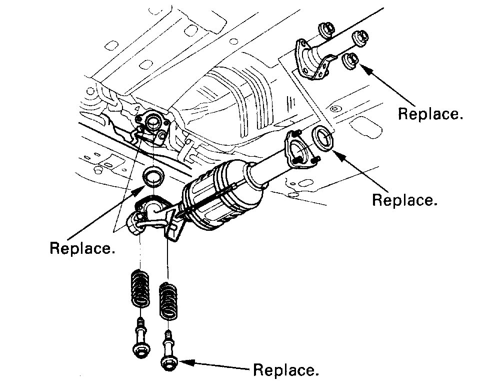

10. Remove the under-floor TWC.

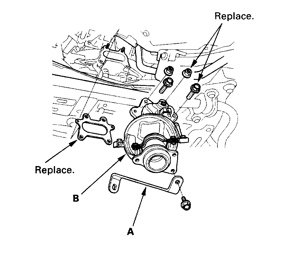

13. Remove the warm up three way catalytic converter (WU-TWC) bracket (A), then remove the WU-TWC (B).
Picture 8

1. Install a new gasket (A), then install the WU-TWC (B) and tighten the bolts/nuts in a crisscross pattern in two or three steps.
Picture 9
2. Install the WU-TWC bracket (C).

5. Install the under-floor TWC (A); use new bolts (B), new gaskets (C), and new self-locking nuts (D).

10. Install the A/F sensor.

11. Connect the A/F sensor connector (A) and the H02S sensor connector (B).

13. Install the IMA power cable clamps (A) and the bolt (B).
