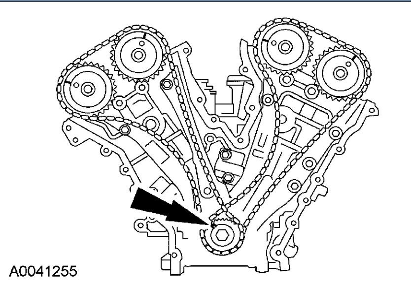

Timing chains are the other thought. Have you ever had them replaced?

The timing chain controls valve timing. If the chains are worn, that timing will change and you will get less mileage.

if timing chains are bad it should have sound? engine working fine no bad sounds
Jan 24, 2019 at 11:33 AM
no, not at all. They slack off and you cannot hear that at all.

thank for answer. how can i check if chain went bad?
Jan 24, 2019 at 12:03 PM
You would need to do a compression test and compare the readings to new.
Then the cover for the chains should be removed to inspect. That is a big job and if you are going to go that far, then you might as well replace it.

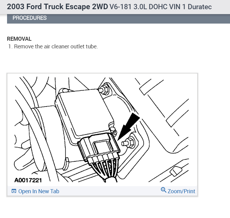

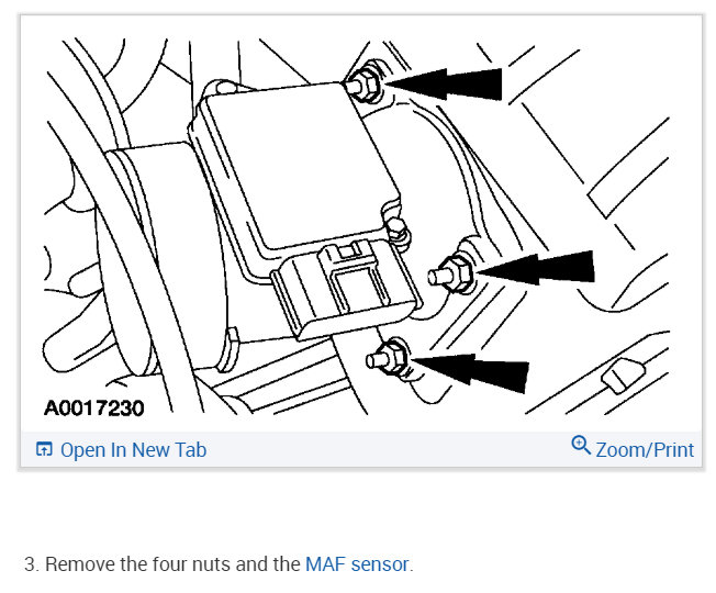

I have seen MAF cause this problem even though the numbers are kind of where they should be the sensor shows less air than what is entering the engine. I would replace it will new. here is a guide and diagrams below:
https://www.2carpros.com/articles/how-to-replace-a-mass-air-flow-sensor-maf

installed new maf sensor, also compression test was done "perfect numbers"
now showing
Shrift1 (%) -7.8
longft1(%) -13.3
shrift2(%) -7.8
longft2(%) -8.6
maybe air leack ? car drives good
