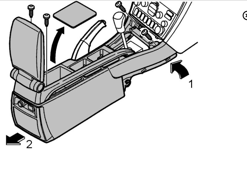

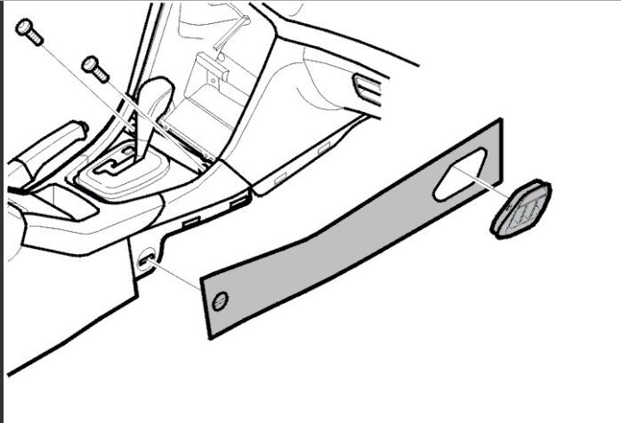

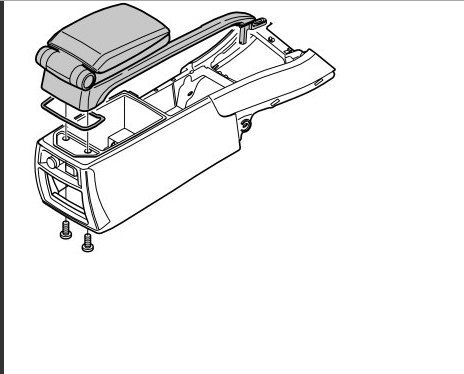

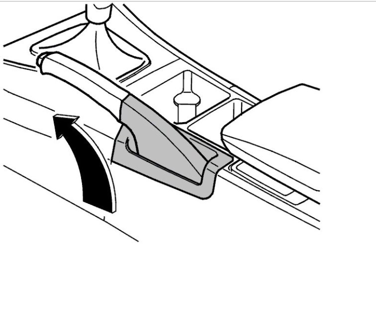

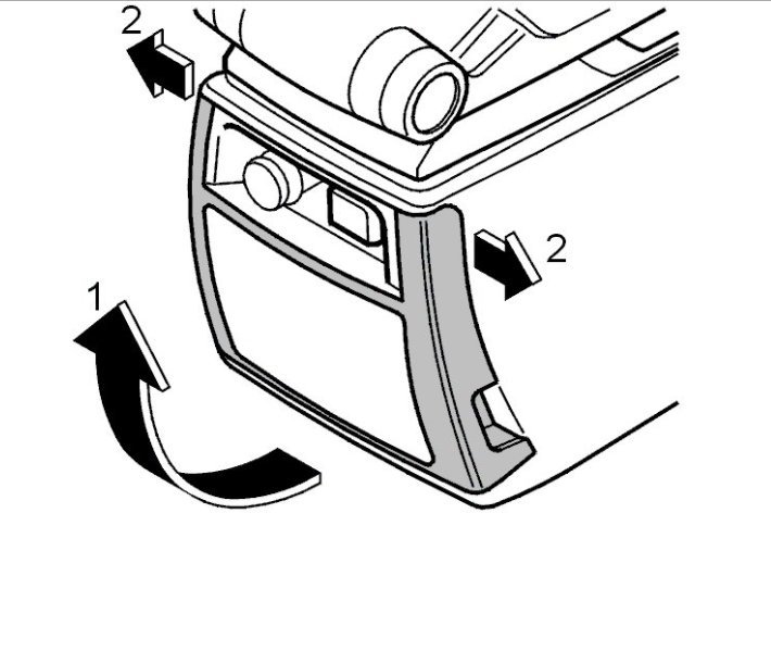

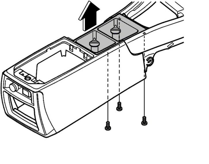

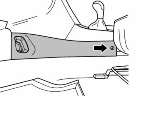

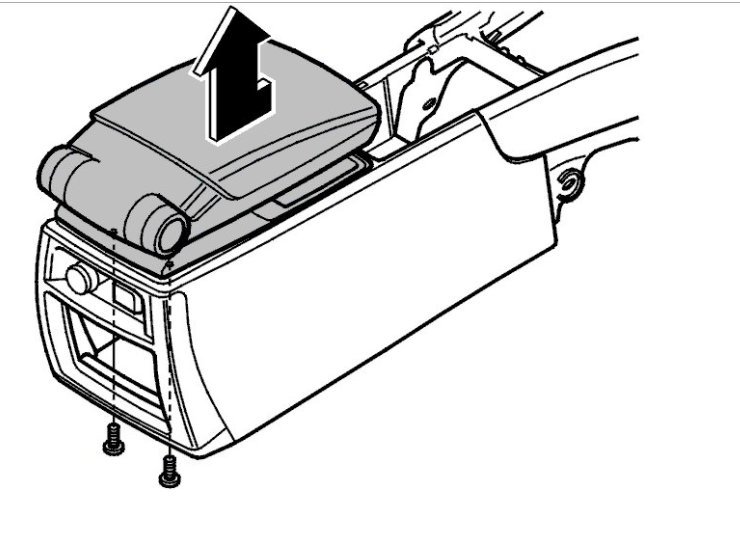

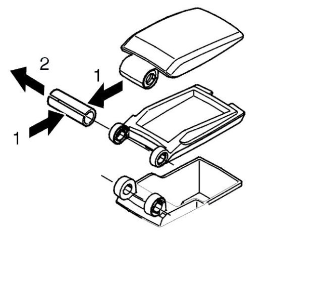

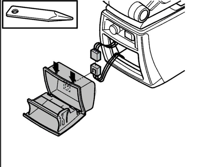

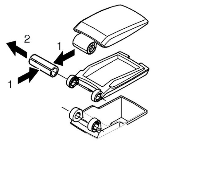

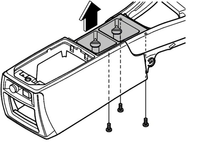

Is there a diagram or set of instructions you can guide me to as to how to dismantle the center console to replace with the new shift repair kit no. 9463559? Thanks DS
Jun 6, 2017 at 5:39 AM

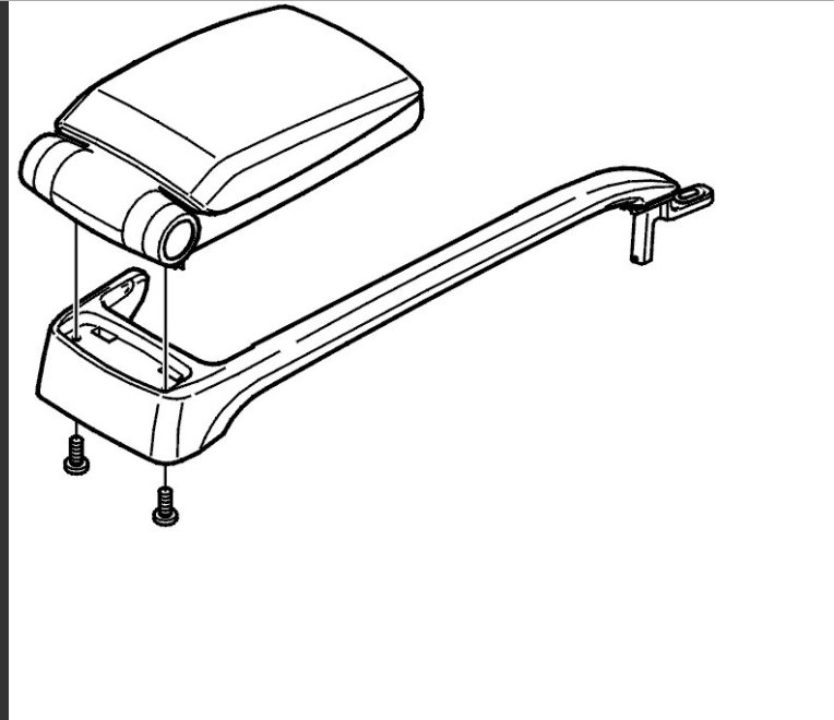

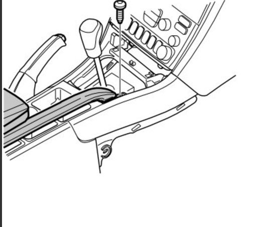

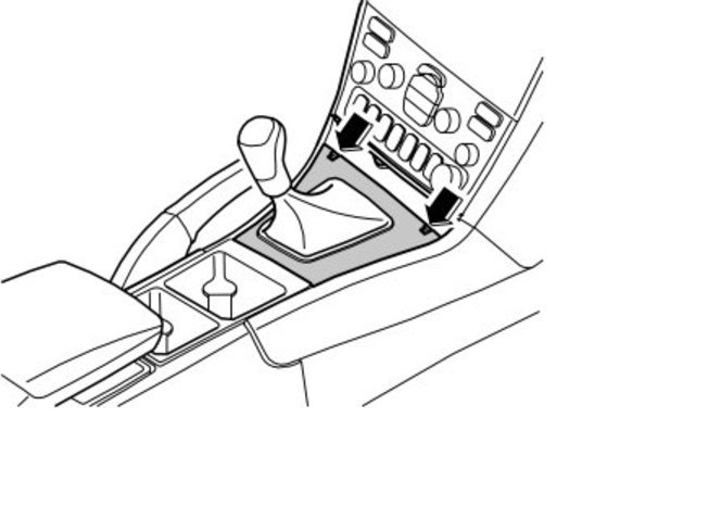

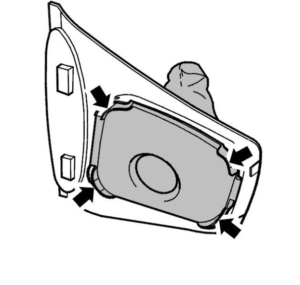

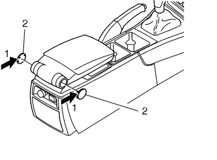

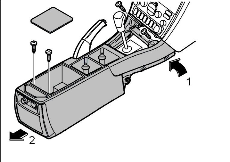

Is does not look to bad, here are some diagrams (below) that will help you get the job done.
