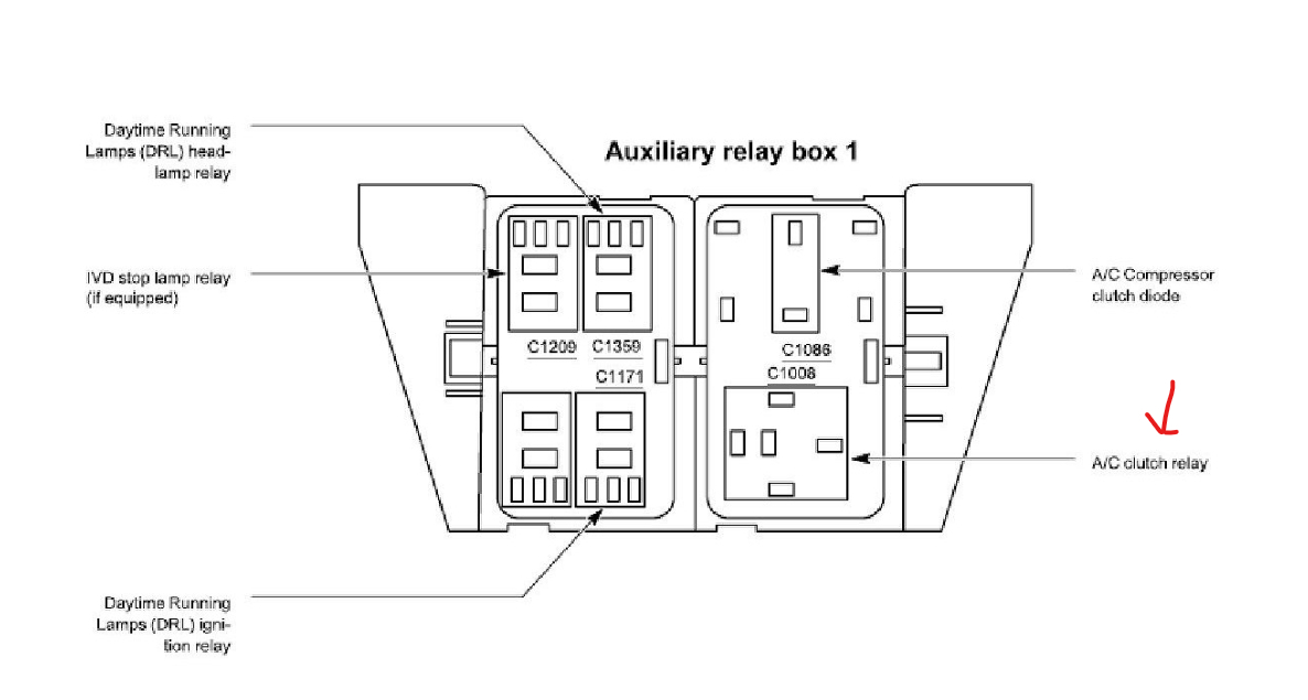

We only handle one problem per thread. Please start new questions for the tune up and transmission fluid issues. The battery draw sounds like the A/C compressor clutch relay is stuck on. so, I would remove it to see if the drain goes away, here is the location of the relay and a guide to help you go over the easy fixes for the is as well.
https://www.2carpros.com/articles/car-battery-dead-overnight
