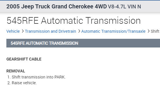

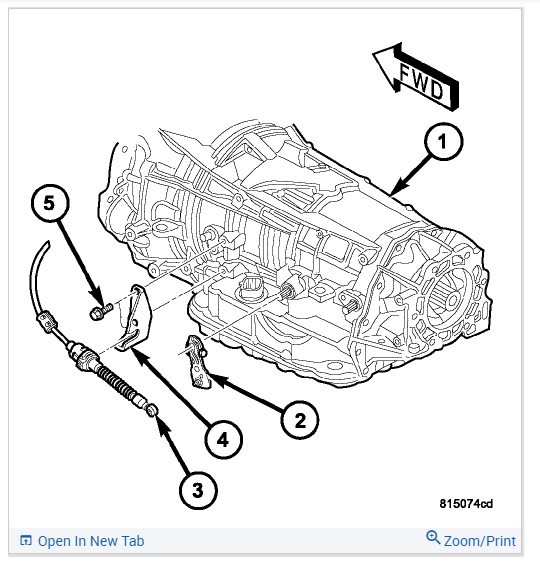

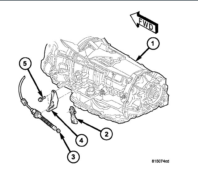

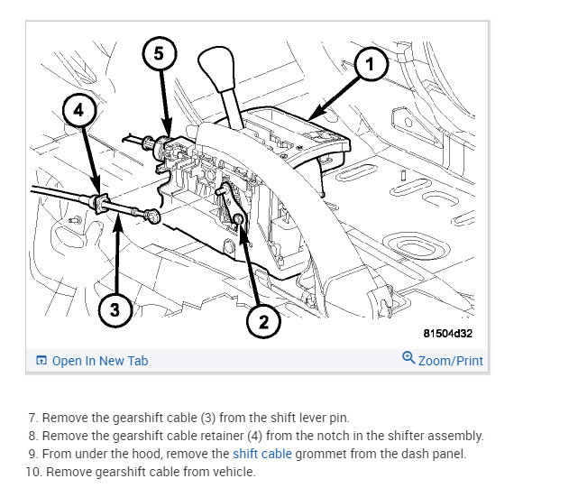

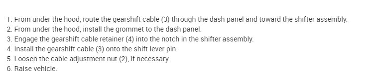

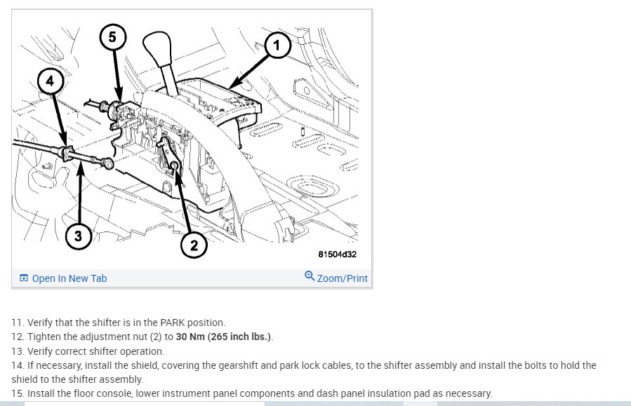

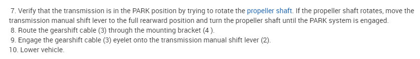

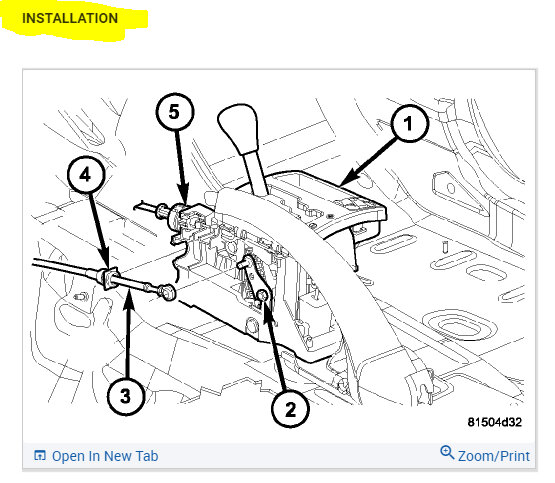

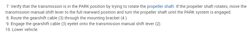

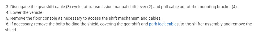

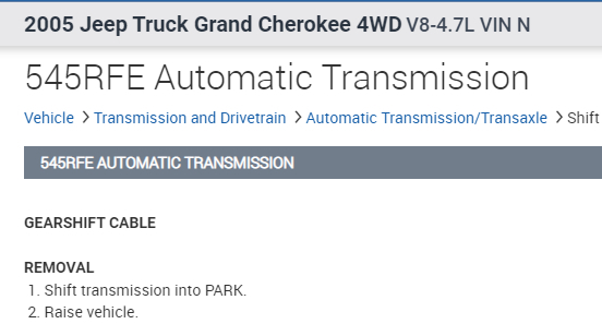

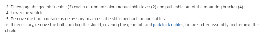

I'm assuming this is a 4wd vehicle. If that is incorrect, let me know.
I attached the directions below for replacing the cable. As mentioned, this is for a 4wd vehicle. If that is not correct, let me know.
Let me know if this helps or if you have questions.
See pics below.
