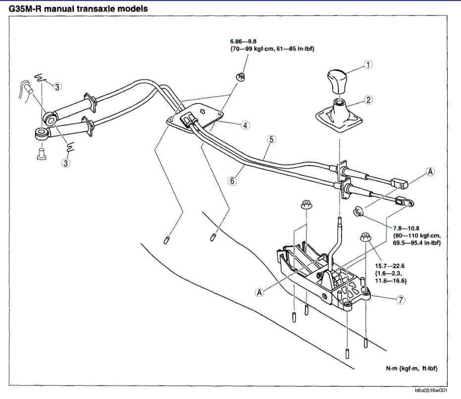

That is an odd one. It sounds like it is related to heat. However, I have to ask if when you drive in or to town, are using 5th and 6th gear.
I attached a pic below of the shift cables that go between the shifter in the vehicle and the transmission. When it locks, I would have a helper try shifting to see if you notice any movement in the cables at the transmission. Also, you could disconnect them at the transmission to see if you can manually shift the transmission right at the shift levers.
If you can shift it with the cables disconnected, then we know it is a cable issue. If you still can not get it to shift, then it's likely internal (something getting hot and expanding).
Let me know if this is something you can try.
