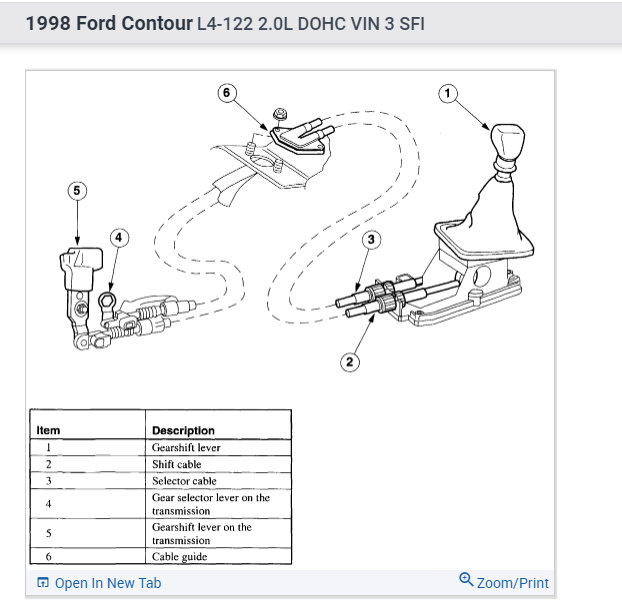

When this happens are you moving and the wheels lock or do you mean the shifter itself won't move?
If it is the shifter itself that is causing the issues, it could be a bushing or adjustment issue with the shift cables. I attached a pic below showing them.
Check to make sure where the cables connect to the transmission there is no excessive play or worn nylon bushings,

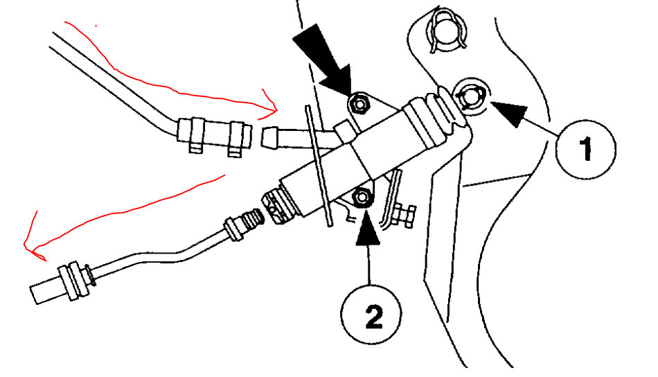

That's a hard question to answer. It really matters how bad the leak is at the slave.
There is a clutch master cylinder attached to the clutch pedal. See pic 1. If you look at the arrows, fluid comes from the brake master cylinder and then is sent to the slave.
Since the brake MC is also the fluid reservoir for the clutch MC, you really need to keep an eye on the brake fluid. Note that the transmission will need to be removed for the slave to be replaced.
On a good note, the transmission gears aren't the problem. It's the clutch that won't disengage the engine and transmission so you can shift.
