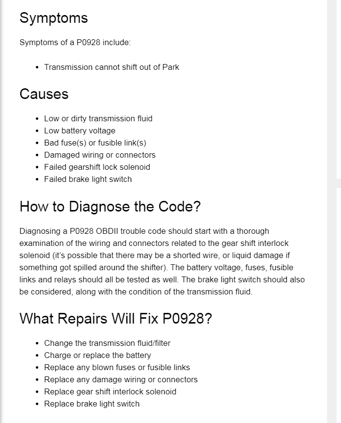

The error code in the transmission module is:
P092800 GEAR SHIFT SOLENOID CONTROL CIRCUIT OPEN
Below he writes:
LOT'S OF COMS FAULTS AND UNDER VOLTAGE CODES.
